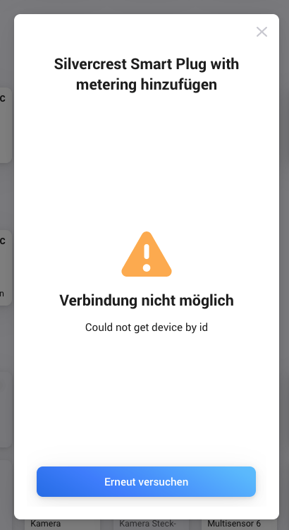

I have a problem with the Lidl app and my Lidl Zigbee sockets. I was able to add these but no energie values are transmitted. If I then want to switch it off using Homey or try to repair it, I get the following error message. “Could not get device by ID”

This is an issue with Homey, not with the app. See the firmware note for v11.0.0.
