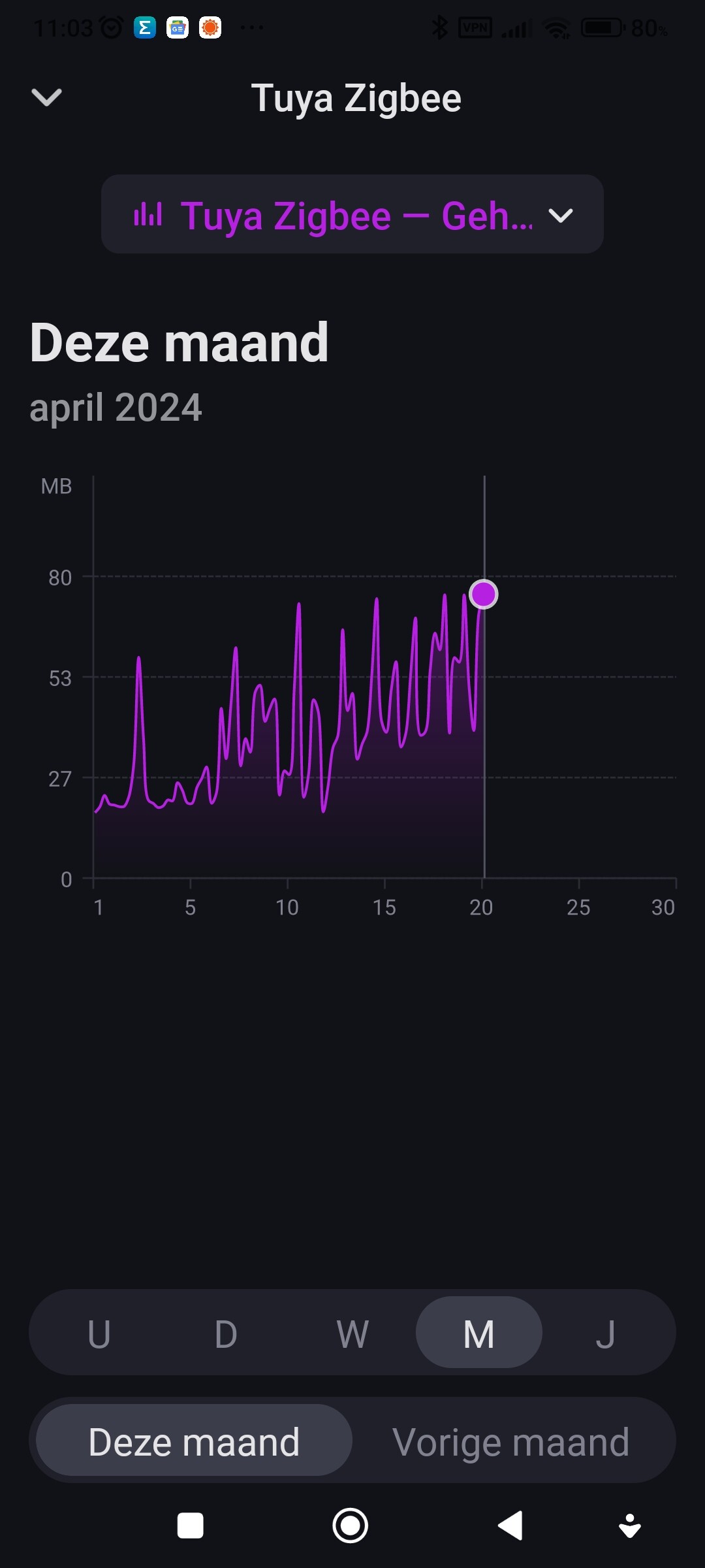

Hi @Sharkys, I came home last night and non of the Zigbee devices worked again, also I couldn’t even reinstall the Tuya Zigbee experimental app again so couldn’t turn off the device’s through the app and the flow’s didn’t do it either, I disconnected the Homey for 10 Min to do the jobs. Here added the Graph’s you asked for.
They are from this month, if you want other ones let me know.
Best regards Peter.

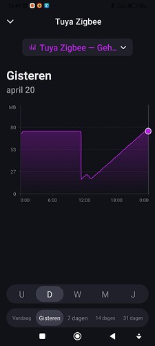

@Sharkys ,
Hi here they are from yesterday.
Best regards Peter.
It looks like that the app is getting killed, because it’s causing some kind of memory leak - that’s the flat line - that’s why the app “disappear” - until it would be fixed by Johann, I suggest to implement regular app restart every 10 hours. If I’m not mistaken, it’s known problem but unknown cause of it and it do not happen for everyone. Can you post the Tuya devices you are using, best as text from de. Zigbee view https://tools.developer.homey.app/tools/zigbee ? Maybe that could provide some insights for the future.
