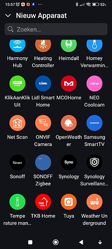

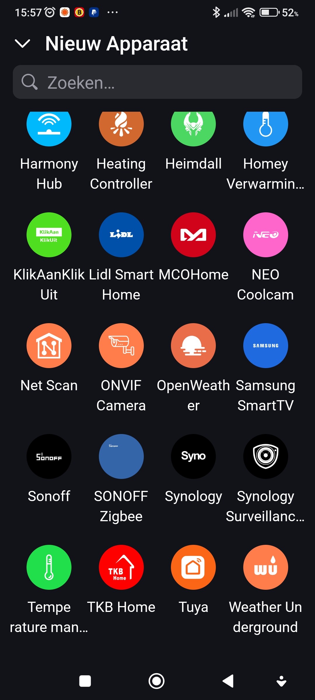

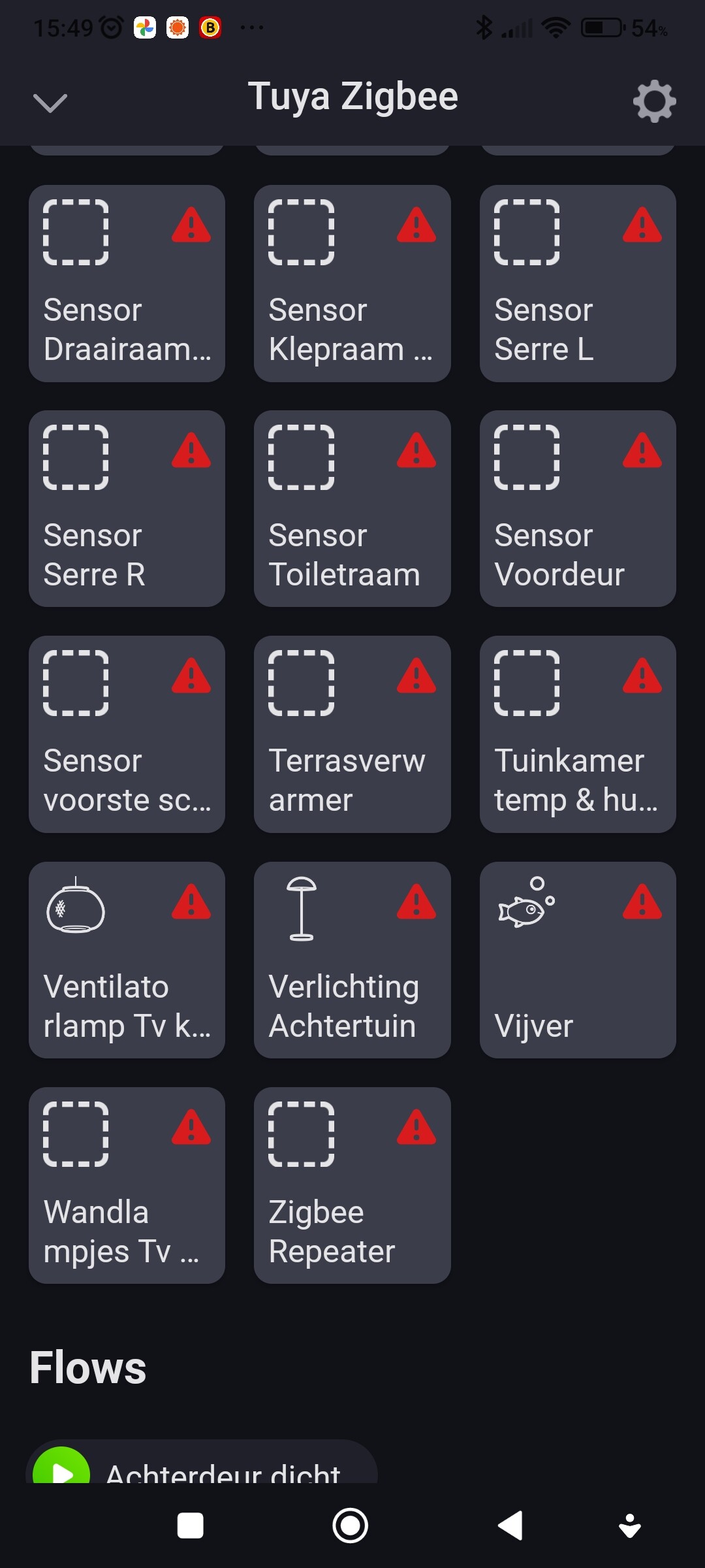

Hi there, I’ve got the problem that all my Zigbee devices are offline every single day, I’ve reinstalled the Tuya Zigbee experimental app but it keeps happening see screenshots.
Did anybody had the same problem and found a solution for it ?
Best regards Peter.
The Tuya Zigbee app even disappeared when I’m trying to add another device see next screenshot.
