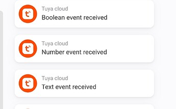

Hi all, anyone knows what is going on here? I keep getting Homey notifications and Simple Sys Log app is posting the same notifications on my Homey timeline. As far as I know, I haven’t changed anything. Maybe an update of the Homey or update of the Tuya Cloud app, has created this bug.
Via the Tuya Cloud app, I have added a dehumidifier. This works very well since a few years, but since a few weeks, I suddenly get these very annoying notifications. These notifications are not coming from a flow. It’s either from the Tuya Cloud app, or in Tuya Smart on the desktop they have changed something. The dehumidifier has not get an update.
My Homey 2023 is updated manually. Tuya Cloud app updates automatically. Anyone knows where this issue is coming from? Till now, either I have to stop Homey notifications, but that means all which is not nice. Or disconnect the dehumidifier from Homey, but that also not nice as it is programmed with flows. Hope someone knows how to help!

:thinking: you are sure you do not have a flow active doing this? Somewhere tested something and forgotten to remove??
The notifications are sent by Simple Log, as shown by the icon.
From the actual notification text, that is data from the trigger “When text/number event received”
and you connected it with either the 2nd or the 3rd Simple Log action cards shown below.
You’d want to use the first card to have it log to Simple Log only:
There’s no pushed stable update since July 8th '23, you can check it in the changelog @ app store:
Also, auto-updated apps is not a hidden action, it sends notifications to your timeline.
