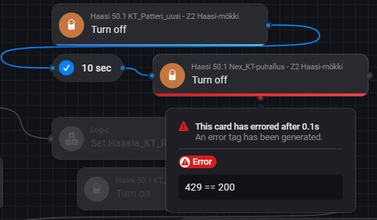

Really loosing it with Telldus… seems to me that they have applied now strict 10sec rule and even then 2nd command rejected. Have you noticed same or related to something else.
Changed code now back to as completely unreliable to make any command from Homey side (wo checking every time if command accepted ![]()

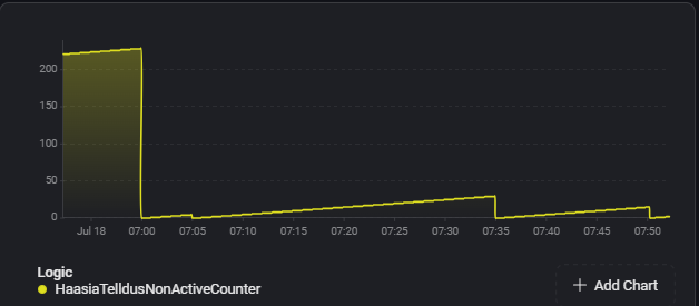

To close the loop, I think I found (dirty) way to solve it: restart app - never tried earlier for some reason ![]()
Now, if non of 3 sensors I am following is not updated within last 25+min (at fixed times every 15min), I will force auto-restart of Telldus-app (at suitable time for flows) and issue seems finally resolved when stated this morning
Seems that my 300km bridge can be used for some more time again.

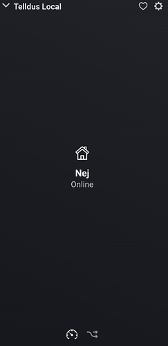

Hi!
I have used Telldus Live Local v1.3.1 for more than six months with no issues. But suddenly it stopped working and gives error message, 401 == 200, and Telldus Local seems offline.
I have restarted application, Telldus gateway and Homey but it doesn’t help.
Any ideas?
Thanks!
I have the same issue, have you found a workaround other than restaring the app? i use Telldus as a range extender for sensors that are out og reach for Homey.
No, and actually as I was still getting sensor updates stucked, I nowadays even disable app if no updates for some time… added this to secure remote data pull.
As said before, Telldus is used in my case every 15min + 13min to push commands to remote location based on latest measurements and Homey script calculations. For this reason possible 15+2min to 7min not used anyhow…
Assuming less than 5min might be OK as well, but as no need to reduce, did not test…
I think hard to fix as looks to me that API-side blocking IP (or something similar).
