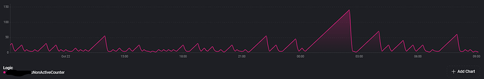

Even with this strategy, still sensor (3 pcs at that location, update comes every 5-6min from one of them) any-update might take several disable-cycles as seen in last 24h chart (when ever counter more than 15 at every 15min+2min, disabled as seen in flow)
After counter >=120 Homey flow drops its control, and Telldus will (even if not connected as “Homey want to control ON” is not/cannot be activated) knows to take over and to use simplified (time before Homey) local Telldus-control for same activity.
Adding disable-flow made sensor update restart much more reliable and yet sufficient for my needs while later securing API downtime activity (while thinking to replace it with something else when time)
