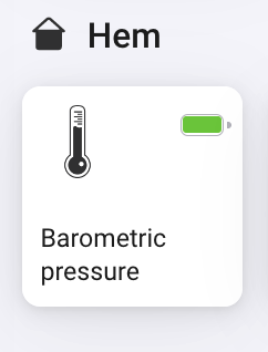

I have a home made barometric sensor (lufttryck) using the Oregon rain sensor protocol that shows up perfectly in Telldus but I have never been able to get it to show up in Homey.
Until now that is…after I installed Tells Live app I could find the sensor, but the only thing it’s showing is the battery level. No value at all. This is how it looks in Homey:
Skärmavbild 2023-12-14 kl. 20.34.07
I did go to https://api.telldus.com/explore/sensors/list to see if I could find anything that stood out but to me it could just as well be a Martian language. I did compare to another rain sensor (that Homey found using the Wireless Weather Sensors app) but to me they look very similar. I’m just not knowledgeable enough to troubleshoot this. Does anyone see anything that could explain why this sensor is recognized by Telldus but not Homey?

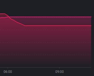

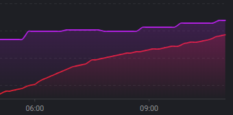

Still seems to issued, but only on Telldus side
Some sensors updating normally on Telldus, but on Homey only one out of 3 updated in last 5h (dead lines):
(red color is from Telldus-data)
vs. (e.g. one of "dead" )

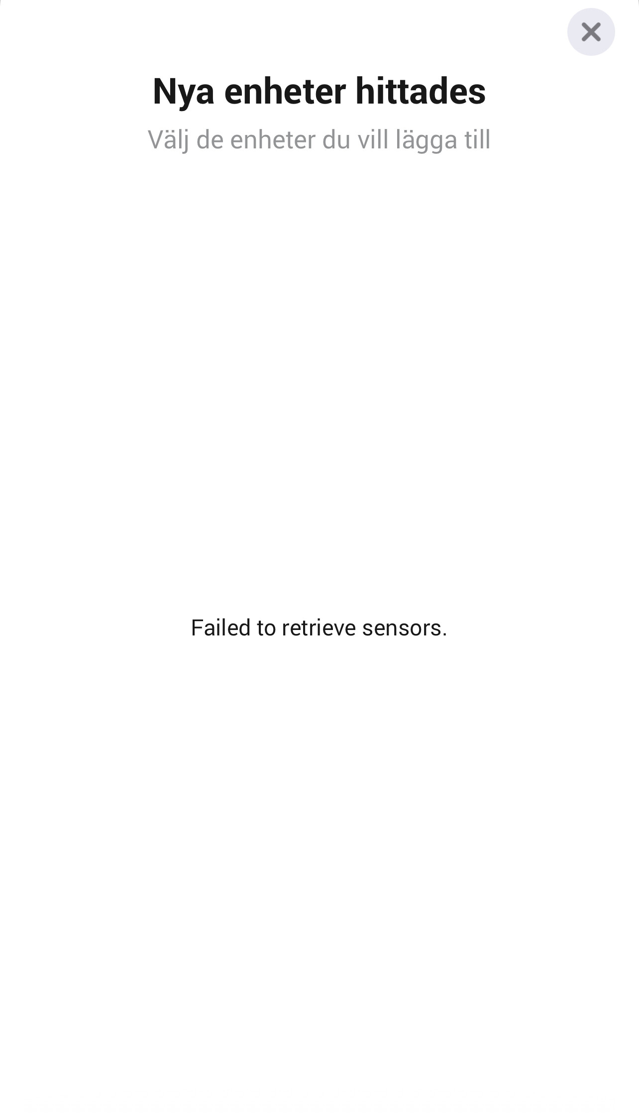

Hi, I still have issues adding the sensors, none are showing up. The switches shows up though.
(After reinstalling the new Test Homey-app and adding credentials). Have you guys really been able to install the sensors?
I am using existing setup (just shifted to Beta-app) and existing ones working (mostly)
Tested (for you) to add extra ones and have same issue (for both sensors and switches)

Thanks @Eko_taas! Very kind of you! Yes I deleted all devices, the client, and the app, and reinstalled everything with the new app (w new api). So something fishy is going on with the sensors. Not sure it’s somtehing wrong with the api now, cause I can se the sensors here: Telldus Technologies now. Seems more like the Telldus Live app isn’t able to fetch the data from the api.

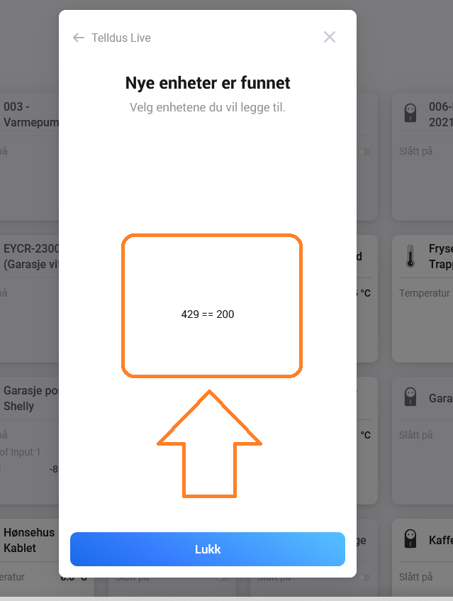

Much working well, but not possible add new devices. See pictures.
Exactly the same here when trying to add my Telldus Live account.
Today i can get new devices from Telldus to Homey.
@Terje_Alvheim - Did you manage to add any sensors or only switches? I still can’t add the sensors.

I have exactly the same screenshoot when trying to add 4 temp&hum sensors from Telldus , How did Terje succed?
