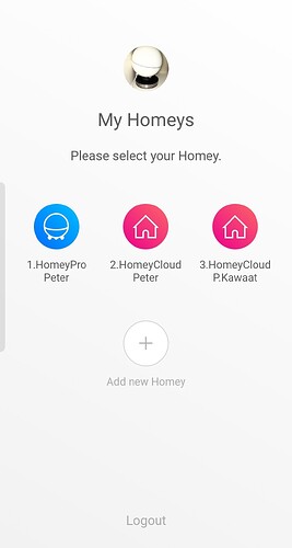

You would need another pro, you can have multiple homeys in your account. You can switch between them.

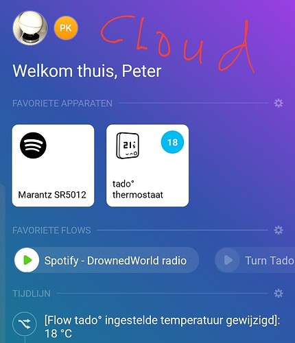

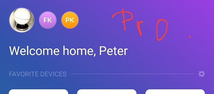

You can use the Homey cloud (+ bridge when you need local protocols) and you don’t need switching accounts, while you are allowed to add 1 Homey cloud instance.
You can switch Homey’s easily in the app
