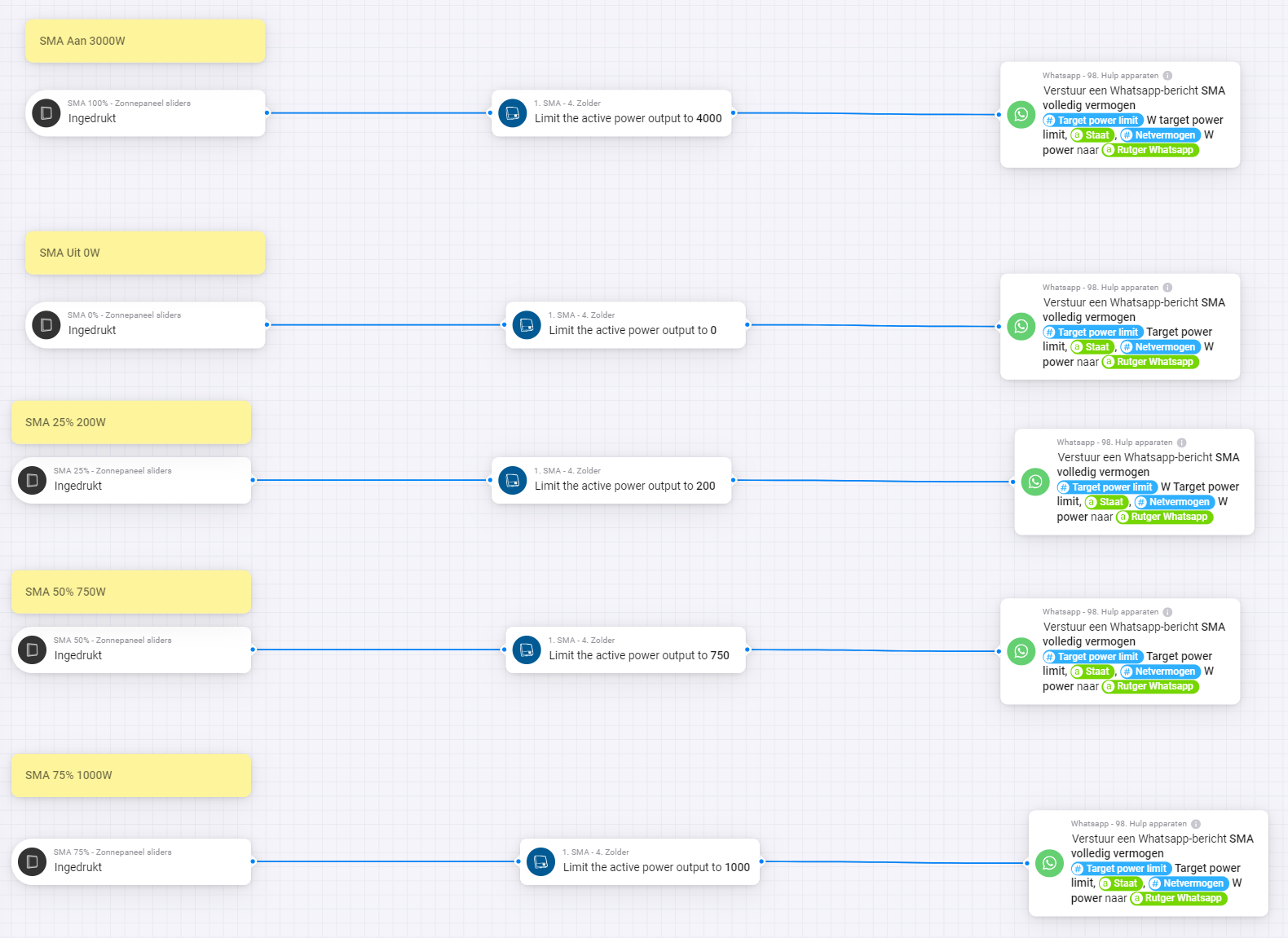

Cautje,
If you’re able to make advanced flow, with virtual devices you are able to have (f.i.) 5 devices, 0%, 25%, 50%, 75% and 100%. Implementation is easy and in the homey app you will be able to use the devices. As an example and more to your requirements (below) The virtual device reacts on the slider of that device and SET the export level accordingly. Straight forward, simple, but I don’t wanna use that at all.
Because I dont want to use this as it will influence my flows, I didn’t test this. It should work though.
[EDIT]
I do wish to point out that inverters have the capability to adjust export however I have 2 different inverters (2 locations) and they both need time to actually SET the %. It’s not a discjockey setting, as far as I observed the last 4 years.
Great, THX!
I wil experiment wit this.
Appreciate your feedback after experiments… Thnks
I think you can now also start flows or not from the device (last tab) . you can make flows with good names and with 0 ,50 or 100% active power when you want to control this from your mobile.
Yes, it is possible. As I assume you mean disable or enable flows with virtual device. Not sure if this benefits from having some virtual devices doing the same or (in the example) a flow with a slider. In any case, the combination of virtual device and the export % function is possible. :slight_smile:
Hi To you @Phil_Bro and @Edwin_Biemond
I first tested wit an virtual dimmer, it works but when everybody leves our hous all lights will go out and in this case alsi the solar inverter…
Also it does not wrkt verry nice with a slider.

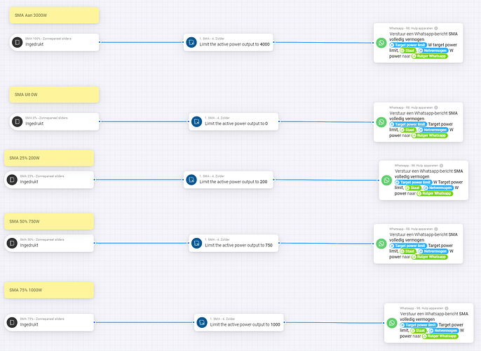

Now i have made virtial buttons, 0%, 25%, 50% 75% nam full power.
This works nice and can be used in other flows.
THX!

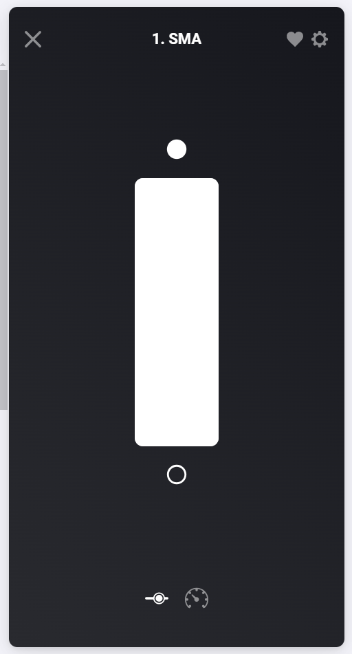

I can also start flows on the flow tab of the device on the homey mobile app. do you see those over there. this is a pic about SMA but solaredge should work the same. If your firmware does not revert the change
