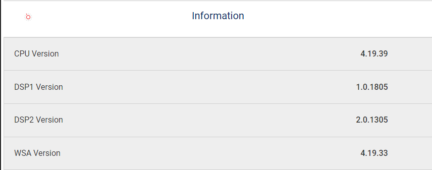

Have followed the instructions, but can’t seem to get any communication established between this App and my SolarEdge converter.
Modbus is active:
I’m using a static IP:
Same IP & Port in the app:
CPU-version OK:
Anything else I could try/look into?
Much obliged for any additional input!

try port no 502. As far as I know port 502 is the one you need to use.

make sure homey is the only modbus app , not also do HA on the side. plus can you do a port scan on this ip if this port is up and reachable.
maybe do dynamic ip , just for testing it,
thanks
Tried that, no change.
By switching it to DHCP, it started working?!?! :smile:
Thanks for the hint, much appreciated!
yep , default gateway , dns etc is always triggy.
