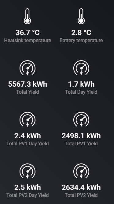

Hi again @Edwin_Biemond and thanks again. I’ve been using the app to control my Growatt inverter for about a year now :slight_smile:
There are currently 2 things that look to be a bit off. One is the battery temperature which we wrote about here
The other thing is the Total Day Yeld which shows 1.7 kWh, however the Total Pv1 Day Yeld and Total Pv2 Day Yeld accumulates to 4.9 kWh. This is what the Growatt webinterface shows as well, so there’s something wrong with the Total Day Yeld :slight_smile:
Could you have a look at this? If so what can I do to help you out?
