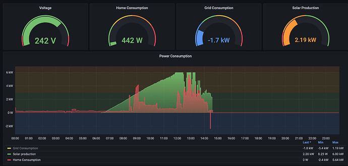

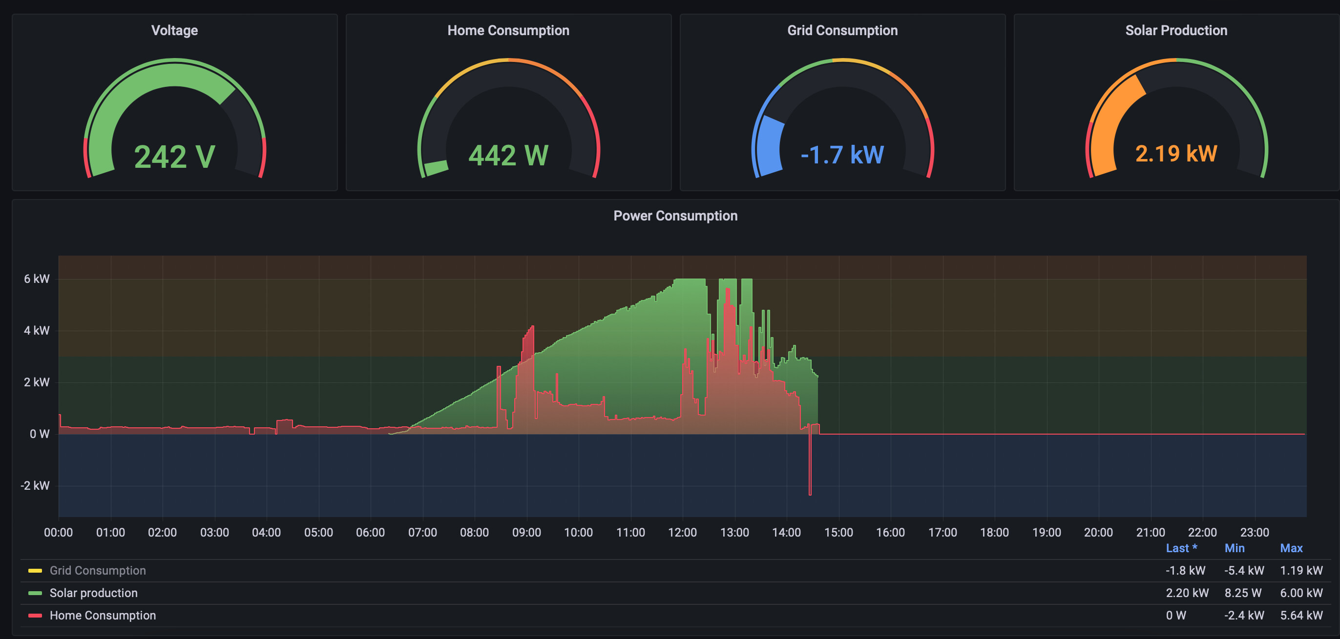

And now I am able to have my Grafana dashboard without calculating from 3 Influxdb query but just reading one. Brillant man !! I would love to pay you a beer if I could !
nice , consumption is calculated. for me I got 1 phase and this goes wrong when batt is full and got a lot of export, with what I use got an extra 1 kw , on the meter it is correct. probably 3 phase or more meters is the solution here. but fine for me.
