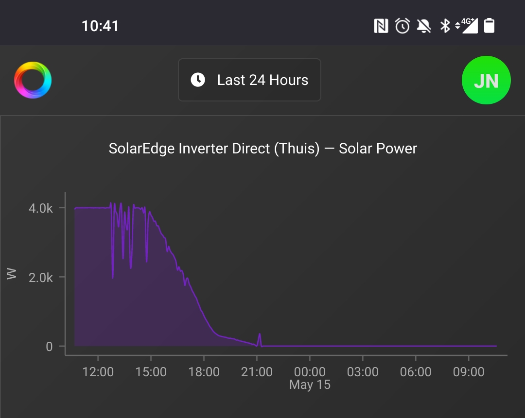

I’m not receiving the production data anymore since this morning. I already tried restarting the app and restarting homey. The SolarEdge app (using cloud) in my phone (not on homey) still seems to work fine. Is there anything I can check why this is happening?

This night’s update seems to have broken the app. Homey got updated to 7.4.1, SolarEdge to 2.0.13. My SolarEdge device is reported as “Device is unavailable”. Trying to access the settings screen gives me a blank screen with no controls (need to force-quit the Homey app to get out of it).
I got things working again by removing the device and add it again (and update all related flows to use the new device instead).
