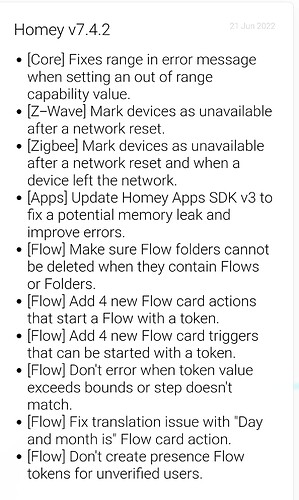

yes, I noticed it myself that homey gets slower at some point. so slow that another timer is triggered when the 1st one is still running. Looks like there is some issue or leak on homey. restart of homey makes it fast again.
for that I changed the schedule to 45 seconds so it does not overlap. Can you try the above test version to see if it improves.
fixes memory leak
Then it wasn’t just me that had that issue.
Ok so I will start by testing with homey 7.4.2 and if the same failure occurs I will come back here and write that and try the test version of you app.
