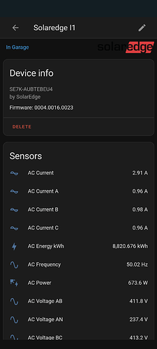

I’ve added my SolarEdge but I don’t get any data… I’ve checked the IP, port and ID.
I’ve waited about an hour and I’ve check the SolarEdge app (for iOS) and it gives me data.
sorry for that , probably there is some explanation.
did you enable modbus like on the 1st post of this forum. Are you using a lan cable ? I guess that is the main part ( I guess you don’t have some kind of firewall )
plus know your ip and modbus port? maybe also check modbus id
after that you can send me diagnostic report so I can the communication.
Also there can be only 1 device at the time using modbus, 1 can block other devices who like to read this data.

I am using wifi. I do know my IP and port (502). I guess the ID is the site_id/installation_ide as shown in the web portal of SolarEdge?
I have no idea of Modbus devices.
Report: c2de89b8-de43-4a09-b603-2b0589f590b7
got it , you are lucky wifi works for you , I will make it more clearer it is the modbus id , mostly 1 and max 15 I think.
