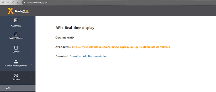

Cloud version, it should work with “all” Solax inverters:
It takes data from Solax cloud (https://www.solaxcloud.com/) and present them in Homey. Minimum update inverval is 5 minutes (it is Solax cloud limitation).
Here you will get Token id:
https://www.solaxcloud.com/#/api
Here you will get Registration Number:
https://www.solaxcloud.com/#/inverter

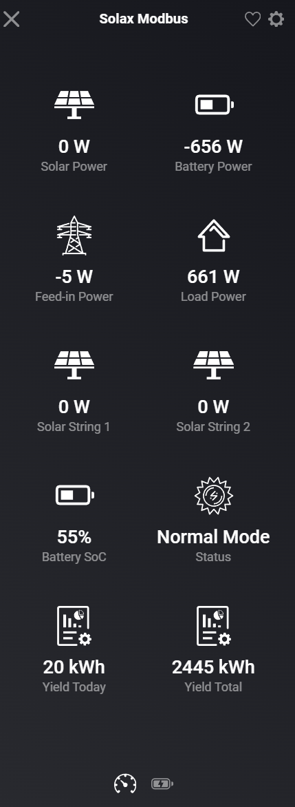

Modbus version, it should work with “some” Solax inverters:
It takes data from Solax inverter directly and present them in Homey. Minimum update interval is 5 seconds. It does not require the purchase of any inverter accessories. You should just ensure, that your invertor will keep same local IP address (usually on router/modem) and link it.
Important: Use internal Ethernet port for connection. Modbus may not be available when you use “stick” (LAN/Wi-Fi)!
App link
Screenshot

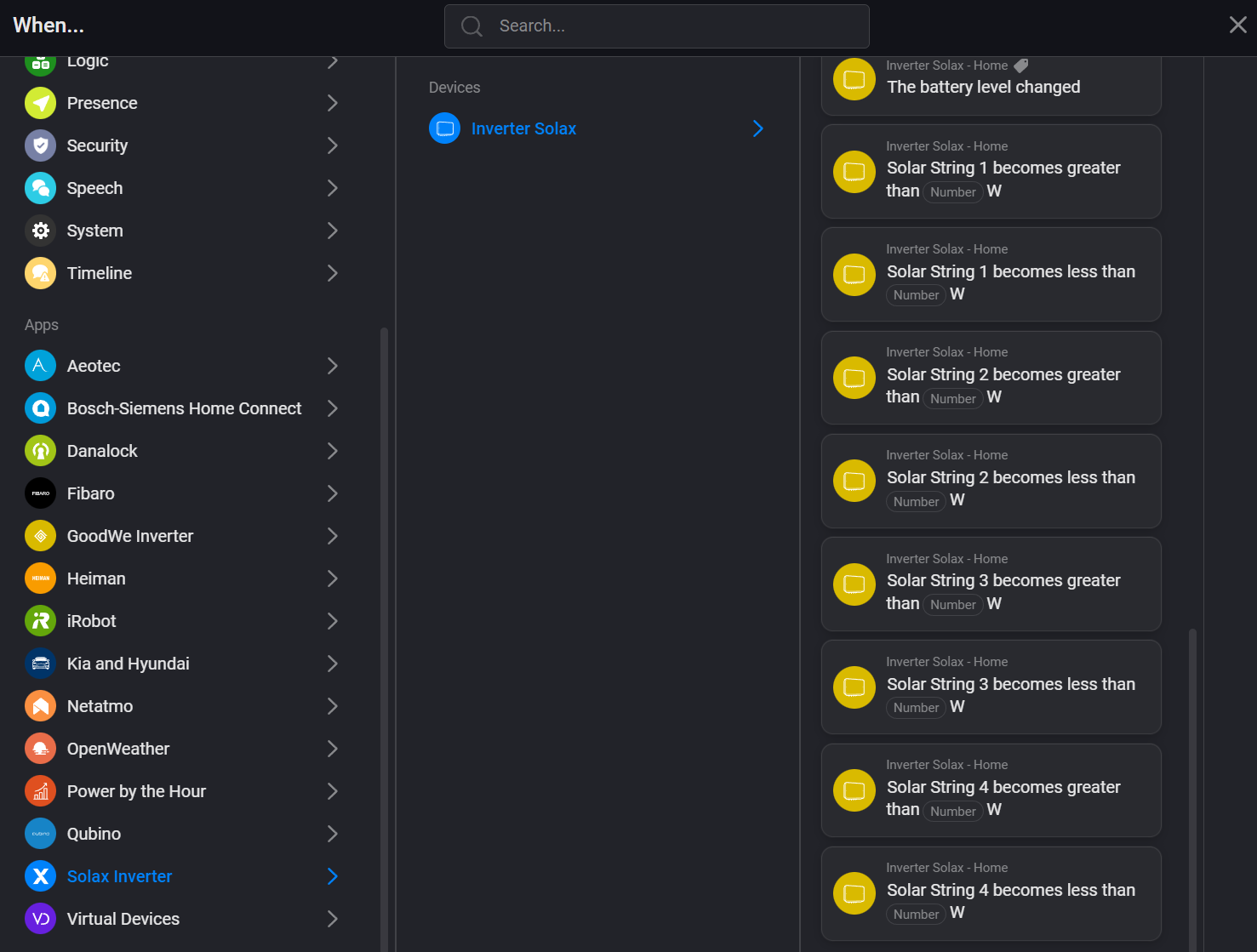

Does this means Michal that we shall be not counting on extending number of triggers and shall be rather using VD/triggers instead, right?
Btw what is you experience on getting there data reflected from the cloud, it’s 5 min interval?
Eager to test it but still need to wait ~2 months…

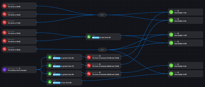

There is a lot of triggers available, feel free use any of them :wink:
I use basically only one, battery level, and based on it system decide how to heat boilers.
Ou, sorry, I was relying on Athom App Store … looks great, can’t wait to test it :slight_smile:
I am not sure, why these triggers are not visible on store, but they work :slight_smile:
