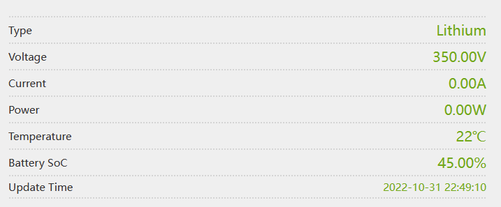

FYI Michal, Solax X3 G4, connected via Wifi Dongle v3 and Cloud, both seems to be working - well done ! I don’t have yet finalized installation but already see some potential to add few more data, like for batteries - voltage and temperature, may I help you somehow to provide some diagnostic data ?
Screen from the Solax Cloud
Also quite a pity that it seems there isn’t Inverter temperature available anywhere, seems even not on https://www.solaxcloud.com.
Also I don’t see EPS Load in the Local version it’s available in the Cloud though.

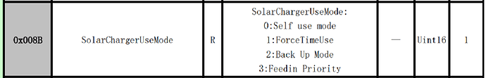

Version 2.9.0 is a great move towards automation. I found a small bug. The Feed-in and Force-Time use mods are switched. Just for info, my inverter is a Solax X3 hybrid G4 8kW.
Hi @Ivan_Regal, I just tested it and it work as it should on G3.
In docs, there is no information about different values for G4. Are you sure about it?
I’ve just tested it and now everything is OK :ok_hand: Maybe, my mistake in some workflow…
Hi @Michal_Stranik,
I was too hasty :-). Working mods are really swapped. Below are excerpts from the modbus libraries. Feed-in in G4 has a value of 1, but in the case of G3 it has a value of 3.
Hi @Ivan_Regal , could you be so kind and provide me source document?
In documents I have (Hybrid X1&X3-G4 ModbusTCP&RTU V3.21- English) there is no information about different values for each model :confused:
Hi @Michal_Stranik there is a link https://gbc-solino.cz/wp-content/uploads/2022/07/Hybrid-X1X3-G4-ModbusTCPRTU-V3.21-English_0622-public-version.pdf, but I think the name of the document is the same as you mentioned above. But look at the page 12. There you can find that definition of SolarChergerUseMode.
