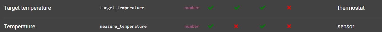

If I look at the capabilities below it seems like target_temperature is not applicable to a sensor, only thermostat!?
Right, then that’s what @Rocodamelshekima means! I’m using thermostats indeed! My apologies to both, didn’t notice that. But the virtual device should be a thermostat for the view I’ve created.
thnx! made a new Virt Device with thermosat instead of Sensor, now see another device with temp indication. Will recreate the flows…
update: got it working, thnx @Martijn_Hoogenbosch :ok_hand:
