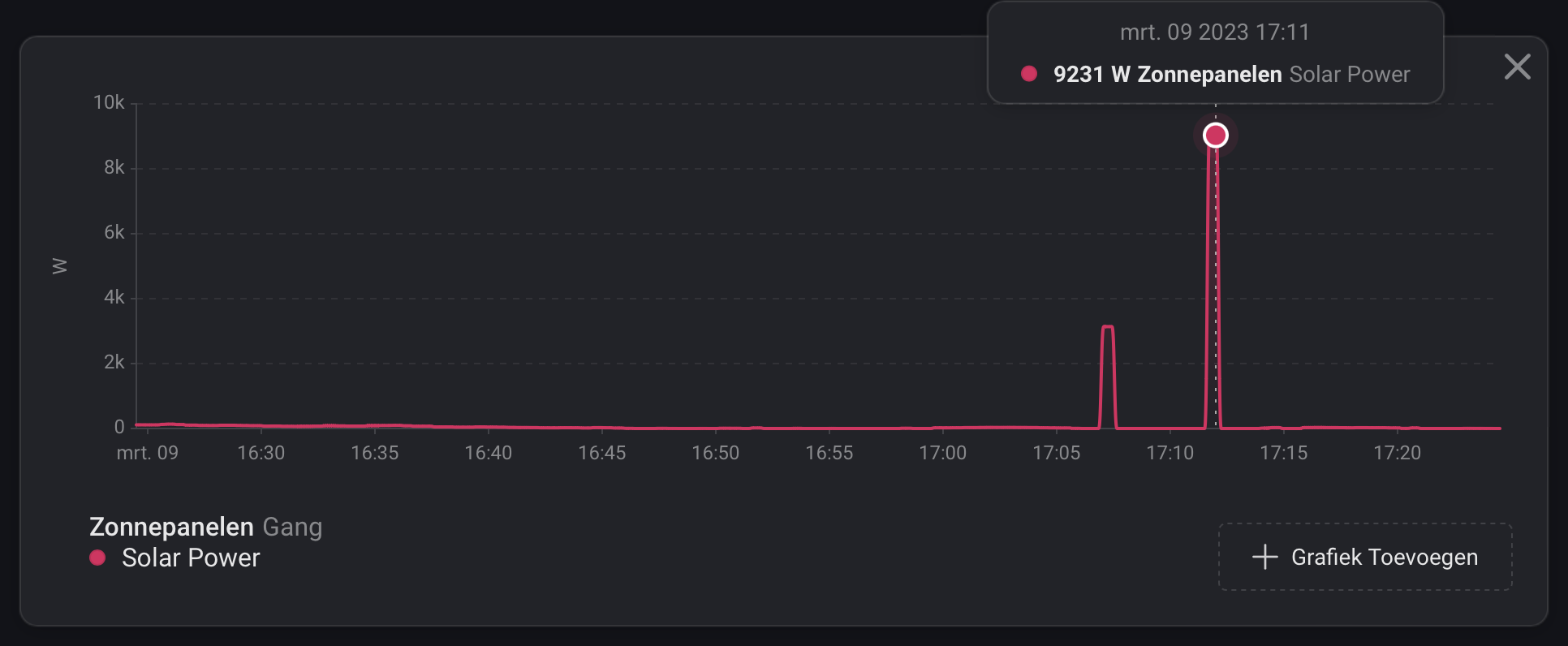

I have a strange ‘problem’. Every day around the same time, the solar panels give a value that is very high and incorrect for a short time. In the screenshot you see 2x high value, we can’t even generate 9000w (there aren’t that many panels). And today it rained all day, rest of the day is also around 30 watts.
In addition to a LUX light sensor, I have the solar panels as a backup for when it is too dark (and the battery of the lux sensor is empty) that the lights go off / on. Due to this sudden increase, the lights go out while it is too dark
interesting, you can send me a diagnostic report during that time. can see if it is the app or not, but I just do pass through. Can try to add some filter but that will restrict it to 5k or so.

This is a report I just made now. The event was around 5.10 pm yesterday. 32907eae-99dd-4f65-a00e-0ef75327a3f1 Or is this data not in the report anymore?

Now something else happend. Out of nothing it gives a value of 0 watt. Can it show this behavior if wifi drops or something? After a couple of minutes 2-3 it is normal again.
Report: f91d7edd-f3d1-4675-8656-eadc8d761bb8
saw your report, it can be your inverter, high voltage or some inverter bug/modbus bug.

wow, are there any issues with too many production?
I see. Thanks for you research. Probably a bug then, I think. High voltage is not reached today, to cloudy. Never had any problems with high voltage…
I only have 5 solar panels on east and 9 on west. So high voltage is not possible i think?
