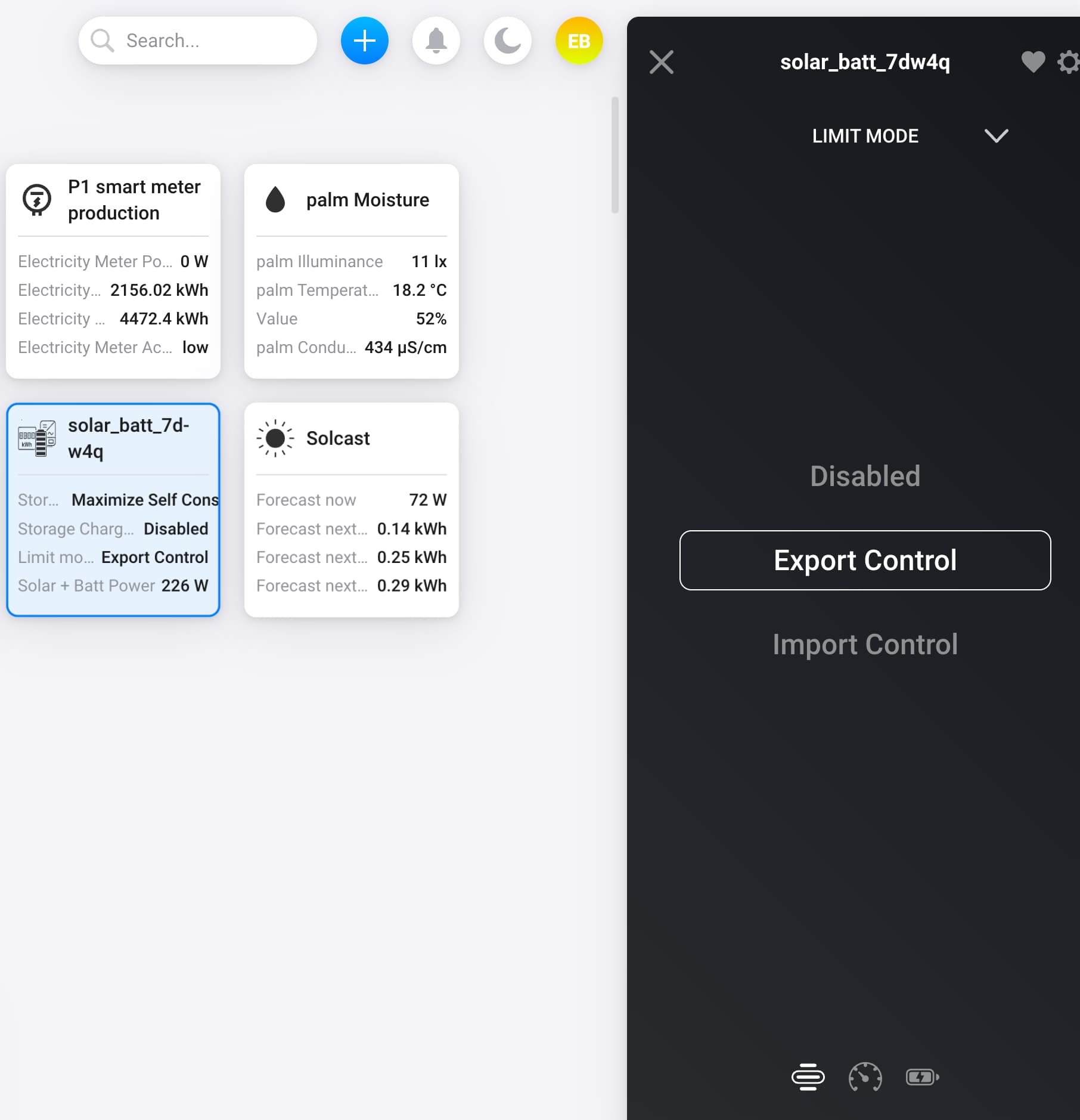

Hey,
you can try to enable export/ import limit from homey flow. make a flow trigger like this
but can you 1st can try to do this on the inverter. if that works we can do this for sure.
also maybe the requirement is, you need to have meters on your solaredge . this is not the same as P1.
if you go to my app on homey you can find the button to send diagnostic report.

let me check this and make a new test version.
Did you try this on solaredge yourself ? and send me the diagnostic report again.
0 means it is not enabled. 50w is ok at least.
and need to check this on your inverter. mostly you see after a hour it goes to the defaults again and need to redo this.
remote_control_command_timeout 3600 xxx Remote Control Command Timeout
I am now making a test version which has this on the normal inverter.

Do I need to enable anything like âexternal controlâ on the inverter?
checking this now, I know I do this for batt stuff. but I think this is basic export/import.
