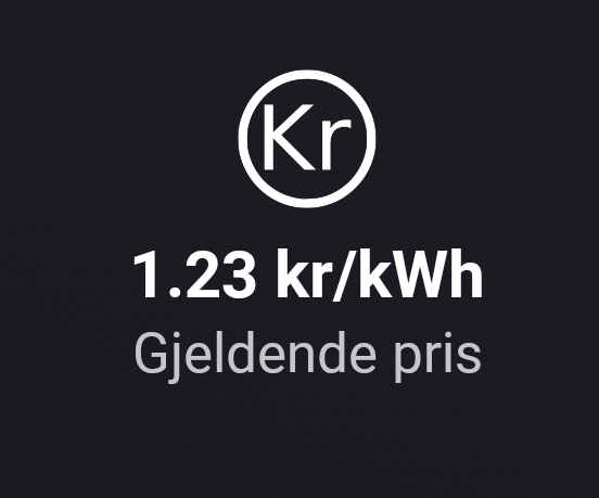

Price still isn’t correct. Not sure why.
Spotprice (inkl taxes and fees): 0,84
Surplus: 0,02
Grid: 0,4355
= 1,2955
Screenshot_2023-07-11-15-13-48-33_4bbfc4a7dd885a2bb189f300112a7ed4

Now at 10pm the price is correct. Any chance the higher grid price between 6am and 10pm isn’t calculated correctly?
You are absolutely correct,
So, in an earlier version, this was correct, but then I changed the hour format for the default setting at some point, which messed this up for new users after that point.
Since I already had it stored correctly in my settings I didn’t notice… also the test program didn’t notice because it was using the correct hour format. Thus it has evaded my validation script so far. Sorry about that.
Thanks for letting me know, I will attempt to fix it and send out a new test version tonight.
Feels good to be correct for once :sweat_smile:
Great. The difference in price is minimal, so doesn’t affect the functionality in any massive way really, but you know. OCD :stuck_out_tongue_closed_eyes:
