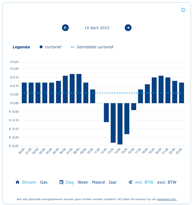

But I know few people use battery and my flows to make sure to restrict import and export else you have to pay more in BE for every 15 min. the max usage counts.
But for dynamic contract you can do the same when you have to pay for export or charge the batt to the max.

You mentioned dynamic contracts where you have to pay for export, is this really a thing? I thought you would always get paid for export?
I still do everything based on a year . all import and export. but some do this by the hour. When there is too wind and sun then you get paid to use energy or have to pay when you do export.
So charge your car and shutdown the inverter during those hours.

Though… I’m still a bit puzzled about the negative energy cost because the cost of the energy is not the only part of the equation, you also have the transport cost of the electricity and this is never negative. Thus if you sum those I don’t think there are many times you will have negative energy, is it? Or are there other factors that make the cost negative, like the temporary support arrangement from the government to account for the times when the energy cost is sky-rocketing?
what I heard you are correct. so 0 or 5ct negative and using a lot of kwh still cost you money on transport cost. but with -25c you make money indeed
I see you had a lot of negative prices yesterday.
I suppose this is not very common but good to have it covered.
Strange situation though, I wonder what the market mechanics are that makes the seller want to give you money to buy power… Sounds like someone has been betting against the prices and need to get rid of the hedge before the prices drop too low because then they will lose even more money.
I worked for the system operator but mostly we have a lot of trouble with wind in denmark and north germany, energy just goes and find their way plus in DE clean energy has priority plus you need gas plant to easily scale down production on time. rest of the power plants this is harder.
if you don’t handle this, the net becomes very unstable and it is very risky. So we can only ask factories to startup or warm up lakes, pump water etc.
Or ask us to shutdown inverters or start washing etc.
