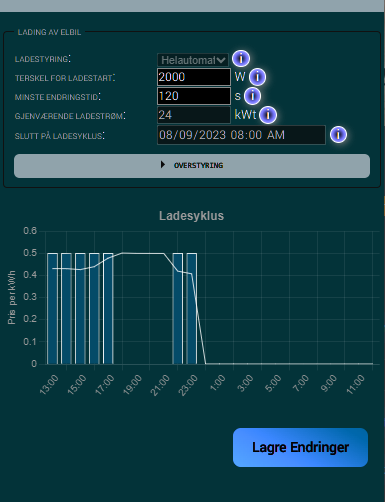

@frodeheg: im still not managing to get piggy bank to control my easee charger.
I get these in the log: (time looks to be 2 hours wrong)
And the cycle looks ok, should be charging now:
But easee says no :frowning:
I know that piggy bank can control the easee, because it turns it off when i turn on easee manually in the app

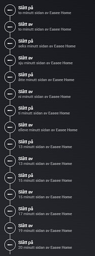

I’m gonna do some more testing today or tomorrow, but i can see from the logs that piggy tries to change the effect on the charger all the time. That cannot be good for the charger i suppose. Should not be doing that all the time…

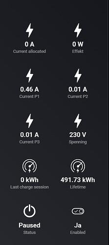

Yes it stays charging when not controlled by piggy.
When controlled:
When not controlled

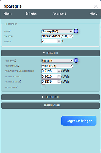

I am struggeling getting the right prices into Sparegris. As i understand it should get the prices from “Strømregning” automatically.
Strømregning shows:
Skjermbilde 2023-08-16 200106
Sparegris shows:
Settings sparegris:
Time:
Anyone that have ideas what I do wrong?
It depends, It will only fetch the price from “Strømregning” if you under “Advanced” → “Cost” → “Usage part” have selected “Price type” = “External”.
If you select “Spot price” then it will fetch the prices directly from the European power broker.
I believe it is a chance that you have selected “Spot price” and have the surcharge incorrectly set (the unit is NOK / kWh)
This is how I have it set up:
Thank you, it was the “External” setting that I missed. When changing to extern it is working. My settings here was like this before.
Great that you got it working.
As you see the grid cost was missing a comma, so that was the reason for the large number. I also see that there is a difference in punctuation between your and my screenshot, I will check if that has an impact too. If it does, then I will update the app.

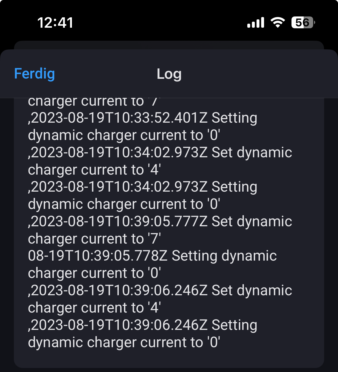

It looks from the timestamps that the dynamic charger current is forced off immediately after being set
e.g.
34:02.973: set to 4, then 0 in the same microsecond
39:05.777: set to 7, then 0 the microsecond after
29:06.246: set to 4, then 0 in the same microsecond
I didn’t think Piggy was capable of changing the dynamic charger current that fast.
Did you extract this from the piggy log or is it the Easee app log? If it is the Easee app log then it leads me to think that it is the Easee app itself that forces it off immediately after being turned on.
It’s from the easee app yes. But I can’t understand why?

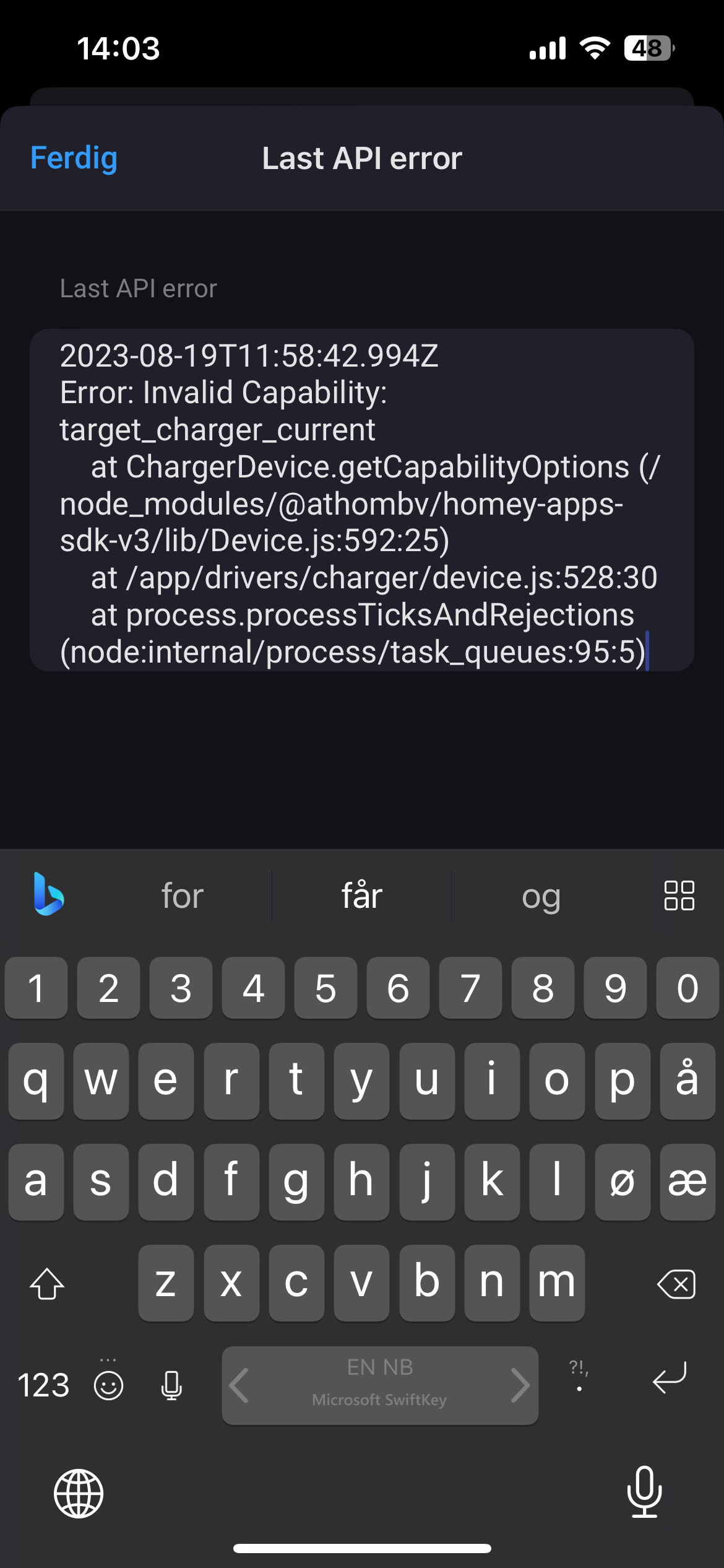

What will be the correct settings for the eaesee charger itself? Should it be set to 1 or 3 phase? I set it to 1 cause my car don’t support more. And should the operator be “none” or “easee” for piggy to work as it should
This also is in the easee homey app, does that mean the easee app should be updated for piggy to work with it again? Do you speak with the developer of that app?
