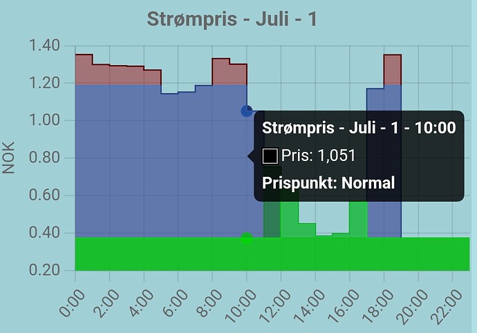

Hi.
Prices don’t seem to update. Thought it was just my homey that had issues, but tried a restart and still the same prices. Been stuck on the same price at least all day.
This is odd, I just got a similar report from someone else using price region NO4, but it seems fine for me (using price region NO3). Are you using NO4 too? Can you please enter the app settings and look at the price history graph and check when it stopped updating prices?
I’m region east. Not sure about the number.

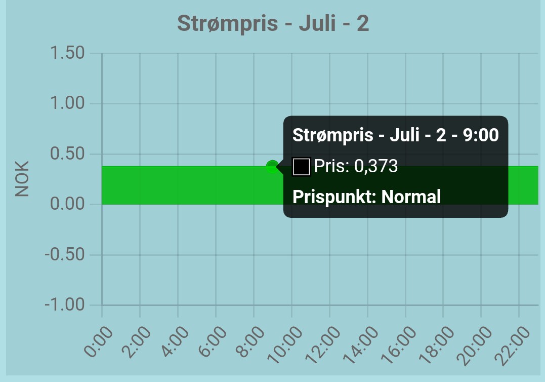

The one thing you have in common with the other person is that on the exact same time this problem occurred there was negative power prices within the next 24 hours…
Thus I believe there is a bug in the app with regards to handling negative power prices… I will take a look tonight.

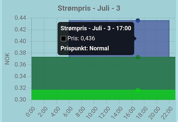

Can’t believe I missed this. I had my price settings as external. Fetching the price from Norwegian utility bill app. That’s the one who stopped updating, hence Piggy bank didn’t get new prices
Changed it to spot. Question. Does Piggy banks 22-6 grid prices apply for weekends?
Piggy Bank supports using the night price for weekends, however, this option is hidden for Norway because I thought it was not applicable here…
