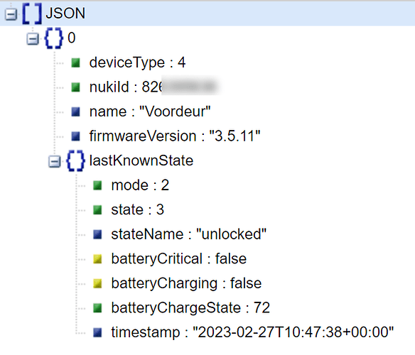

Tried to setup a local NUKI connection using this app, but I’m not succesful and need some help. After adding a NUKI direct device in Homey, the autodiscovery pairing succesfully detects my Bridge and asks for a button press. After de button press however, it says that it hasn’t found any connected devices and there the setup proces stops. Nevertheless, my NUKI 3.0 Pro is recognized and linked to the bridge in the NUKI app and can be operated succesfully.
Tried logging into the HTTP API directly to check the list of connected devices using IP:8080/list. Here it lists the NUKI 3.0 Pro as expected (see below), so not sure why the setup process doesn’t work as expected. Please help - much appreciated!
Never mind - the Homey Community Store has an old version of the NUKI Direct app listed (v3.0.6 from nov 2020) without NUKI Pro 3.0 support. Sideloading the latest version of the app directly (v3.1.1 from aug 2022) through CLI makes it work like a charm.
