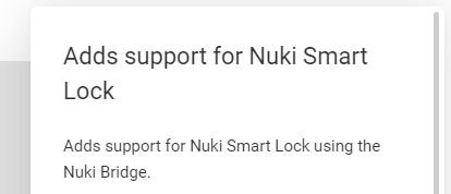

It’s really unclear to me if I need to purchase the combo Locks + bridge of Nuki if I plan to control the locks 100% from the Homey.
It seems that the bridge is only there to alow remote control of the locks thu local wifi and then the internet box.
Am I correct to think that my NukiLocks can interact with Homey thru Z-Wave, so the remote control when outside the house is provided by Homey including lock/unlock/new code settings if I use the pad,…
Or… I need the bridge ?
Thanks for your help
You need the Nuki-Bridge to get it work with Athom-Nuki-App.
I’m not a Nuki user, but I did read!
Yes, i use Nuki myself.
But you need the bridge.
