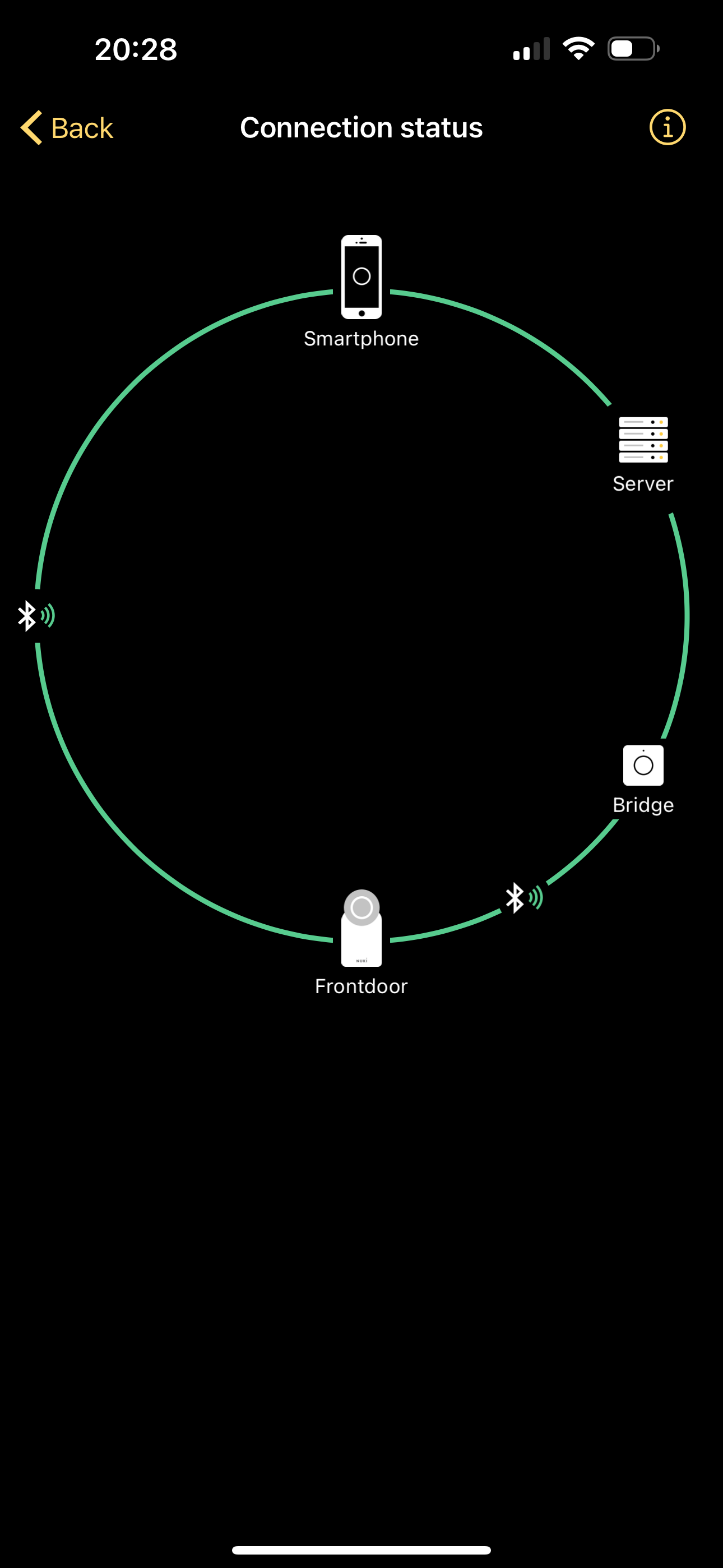

I did the test you asked for. Iphone without Bluetooth and without Wifi, can lock/unlock both locks .
