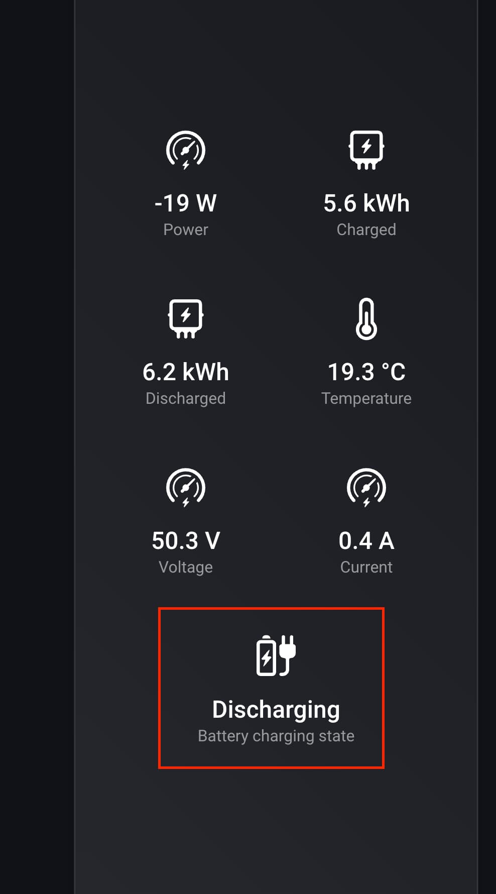

You can try to use th enew JS function as value template:
(value) => { return value > 0 ? 'charging' : 'discharging'}
The conversion works with MathJS with the unit check fix. The JS evaluation seems like a nice addon, but I’m afraid that using pure JS eval can introduce unwanted security risk. I’m totally not familiar with homie’s architecture, so I can’t tell to which data possible XSS attack could have access to, but I know from professional experience that it is a big no no :sweat_smile:
Yes, agree. I hope it’s still safe. It runs locllally, you need to be logged in to set device settings.
And it’s so flexible. Parhaps on MQTT it’s not really needed if you have simple topic values. For HA app I used it for many checks up to array and string handling.
Can you share your MathJS expression? Haven’t seen a number=>text conversion.
:+1:
the initial capability setup works as expected after the fix:
  "battery_charging_state": {
    "capability": "battery_charging_state",
    "stateTopic": "deye/battery/power",
    "setTopic": "",
    "valueTemplate": "value > 0 ? 'charging' : 'discharging'",
    "outputTemplate": "",
    "displayName": "Battery charging state"

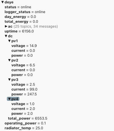

Consider these MQTT topics
I need to create one value from multiple topics. Specifically, I need to create measure_power capability, which would be a addition of deye/dc/pv1/power and deye/dc/pv2/power. How can I do that? I’ve tried multiple ways, but can’t seem to make it work.
For example when I tried mqtt wilcards like deye/dc/+/power, icoming message from subscribed topics couldn’t be processed, becase MQTT Hub tries to match them exactly and deye/dc/pv1/power (incoming topic) != deye/dc/+/power (definition saved in valueTemplate)
The app subscribes to topics. If the topic changes, the app writes the value into the capability.
If you would register topics with wildcard, every topic would appear as changed value and you don’t get the other to sum up.
As workaround you can create a virtual device. Then use the three Mqtt capabilities as trigger and sum up the capabilities into the virtual device.
