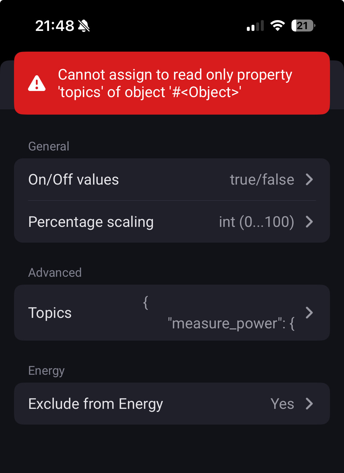

Hi @RonnyW . I’m testing version 4.3.2 and I’m getting an error when trying to set Cumulative energy measuring. Both if I try to set it by itself or if I try to set imported/exported meter capability trough device settings UI
App version: 4.3.2 (Test)
Homie Pro 2023: 12.3.0-rc.7
Capabilities:
  "meter_power.imported": {
    "capability": "meter_power",
    "stateTopic": "deye/ac/total_energy_bought",
    "setTopic": "",
    "valueTemplate": "",
    "outputTemplate": "",
    "displayName": "Bought Energy"
  "meter_power.exported": {
    "stateTopic": "deye/ac/total_energy_sold",
    "setTopic": "",
    "displayName": "Sold Energy"
  "measure_power": {
    "capability": "measure_power",
    "stateTopic": "deye/ac/total_power",
    "setTopic": "",
    "displayName": "Power"
Setting cumulative measuring by itself:
Screenshot 2024-12-20 at 20.12.34
Settings imported/exported:
Screenshot 2024-12-20 at 20.21.49
API call payload:

Hi, thanks for reporting.
This is caused by a null energy object for a new device. Should be fixed now.
The initial settings update for device class is re-added, too. Forgot about after tinkering with the energy settings bug in last rc FW.

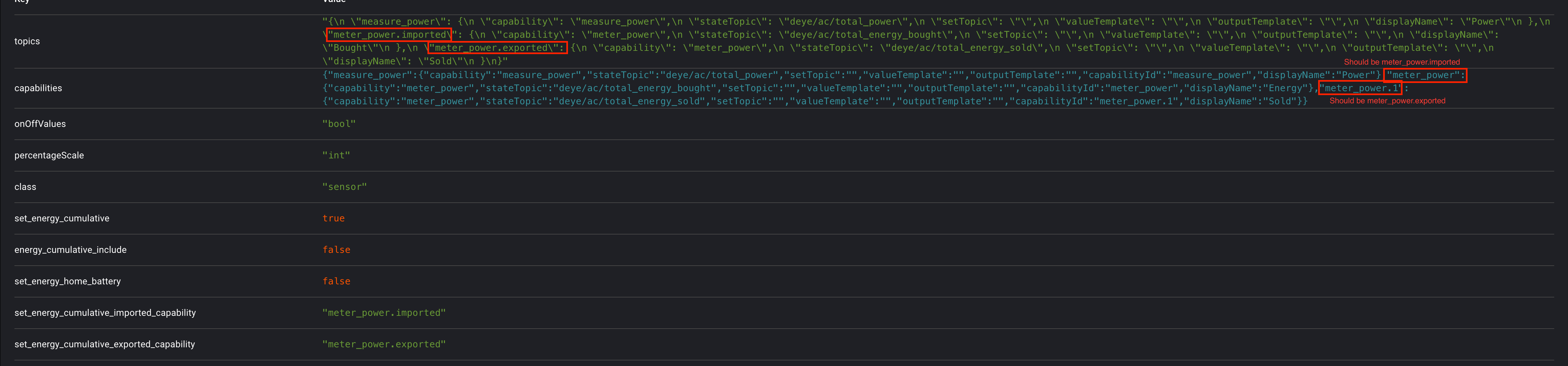

Now that my meter should be set up with correct meter_power.imported/meter_power.exported, I’m unable to see it in Energy tab :see_no_evil:
One thing I’ve noticed in homey dev tools is, that in capabilities property, the “names” of capabilities do not match the names I gave them (ones shown in topics property)
@RonnyW
This topic handling is unchanged so far.
Can you please check what capabilities are present in the device (in dev tools)?
And did you set the “include in total” in device settings? This is needed in addition to device energy settings - because for standard apps the energy settings are static and you have to add the device to energy dashboard using this setting.
