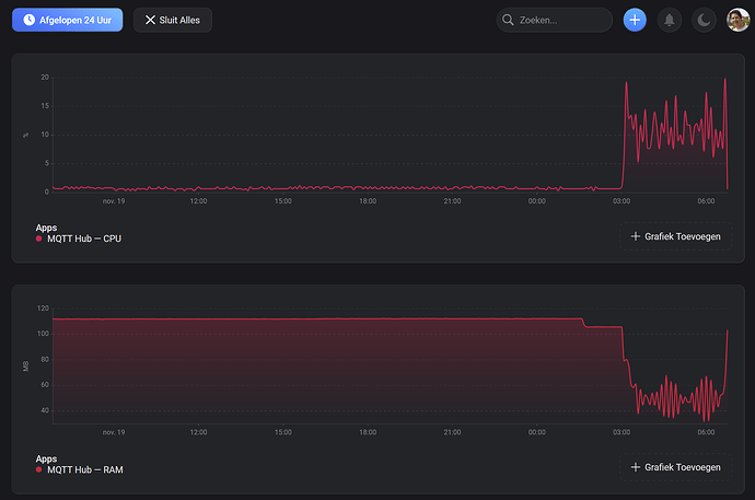

Hi @RonnyW
Recently the app seems to be instable at times.Sometimes with an “Memory Warning Limit Reached”
and other times with an “CPU Warning Limit Reached”
Today the instability began at 3:00 am:
Diagnostic rapport:
a22d022f-3905-4a68-898d-cf67e3623512
Any idea why?
The CPU usage is caused by a sync in most cases.
Was the Mqtt connection broken at this time and caused a new sync?
Did you set a sync delay in Mqtt Hub settigs? If not, please try 20 ms. If you get still crashes, increase up to 50ms.
I don’t think the mqtt connection was broken at the time of the crashing period. I have the broker running on a Qnap nas, and used mqtt explorer on a PC to check the connection. That worked fine.
Thanks for the suggestion to adjust the sync delay. To be honest, I do not have a clou wat sync delay is :sweat_smile: But I can’t find it either in the settings?
These are the settings I have:
Or do I need to set it somewhere in the broker settings (I use mosquitto on the Qnap NAS)?
[EDIT]
Just found out I was running an old version of MQTT hub even though I had the auto-update on.
I see the delay option now :+1:
Thanks.
Now you are using this app/version?
Yes I am now on 4.2.4
