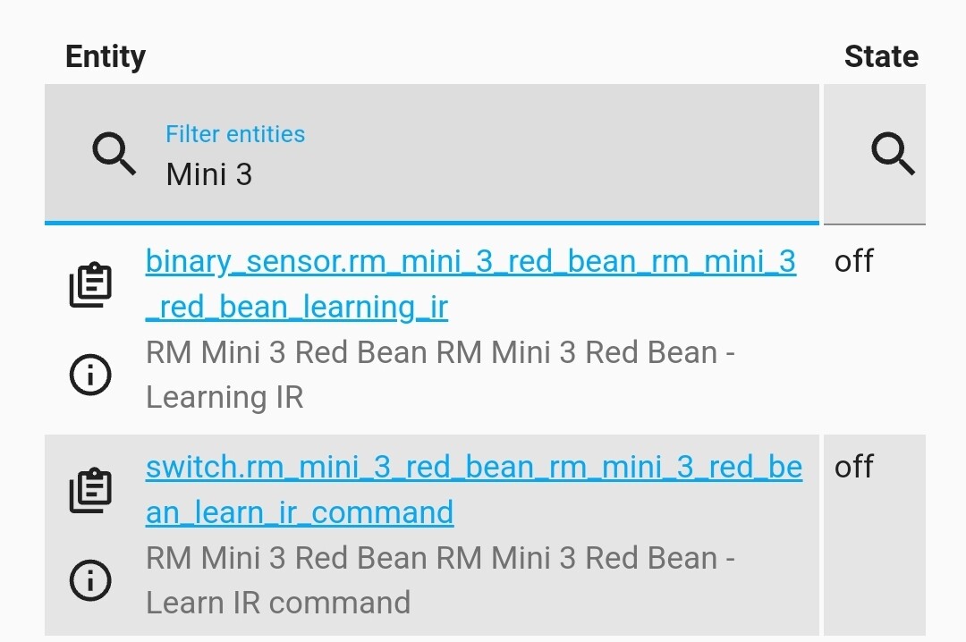

I’ve tried all kinds of settings and made many comparisons, but devices still appear with double device names in HA, regardless of having selected “Capability name” to Capability name or to Device name - Capability name

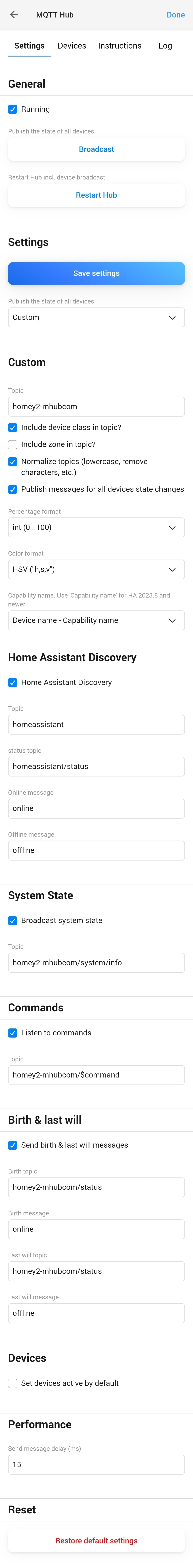

These were the settings, Ronny:
Today I changed the custom settings to ‘homie convention’,
Then I disabed and re-enabled some devices, and enabled some never enabled devices in MQTT Hub, but the device names still appear twice in HA

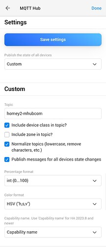

I tried to migrate from the Harrie version to this version, but I ran in the problem that I can’t select Normalize topics… under the custom settings instead of homie convention. so now my HA installation doesn’t recognize the devices from homey because of the capitals in the names… I can select include device class in topic and the publish messages for all device state changes but the include zone in topic and normalize topics checkbox not… installed the latest available 4.2.2. version on a HP19. is this a bug or am I doing something wrong?
Based on a first check it’s a bug. I will check it later…
