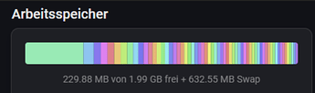

I installed the new homey firmware 12.0.1-rc.8 and see crashes of the mqtt hub community edition app…
12.0.1-rc.8
app => 4.1.4
send message delay configured to 10 ms (like in the stable homey firmware before)
Do you see similar issues?
I restarted the app after several crashes… and it works now… but with very high memory usage…
installed version 4.1.8 (test) now - same behaviour
RAM is almost full, isn’t it? :thinking:
I would suggest to restart Homey also, maybe this will clear some RAM.
already did this, Dirk :wink: as you know - I am a Homey enthusiast and veteran :wink:
It was just an idea…
I haven’t changed the main logic.
Butit can be CPU or RAM related.
With 4.1 the CPU/RAM alert events should finally work. Then I can add a flow trigger to get informed about such events - to know the reason.
And for me it’s also working with 80MB (HP23)
I changed the message delay to 25 ms - looks better now…
but the app consumes lots of memory - maybe you will find the reason for this in near future :wink:
No way. It’s the WebAPI and the amount of devices/messages. All apps are consulting more memory on a HP23 than on a HP19.
For me, the Athom limits are a way too strict for such messaging apps. It’s similar for HA app. But there the WebAPI is not used which saves some MB.

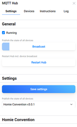

The app flow action:
grafik
Settings view.
  • Broadcast button with light blue progress bar.
  • New button “Restart Hub”
  • New button “Save settings”
@L_Gru : FYI, The capability name can now be changed to capability name only.
