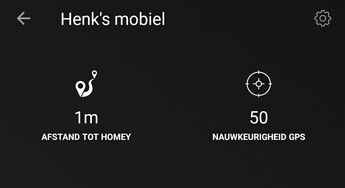

I installed the latest test version, and I only have the GSP accuracy:
when I install the old 1.2.2 version, then I get the gpsLocation also:
But there is something that is even more weird; no matter with what version of the app I create a new device, it wont add the gpsLocation capability. Not even with the 1.2.2 version. The applog show “Unable to set gpsLocation: Invalid Capability: gpsLocation” for new devices. Only the old devices do get updated, but only when I run the 1.2.2 version. The newer versions don’t have the gpsLocation capability at all, or so it seems.

As the device shows distance to Homey and gps accuracy, it does report gps location to Homey it seems.
It’s position is just not shown as a logic card.
