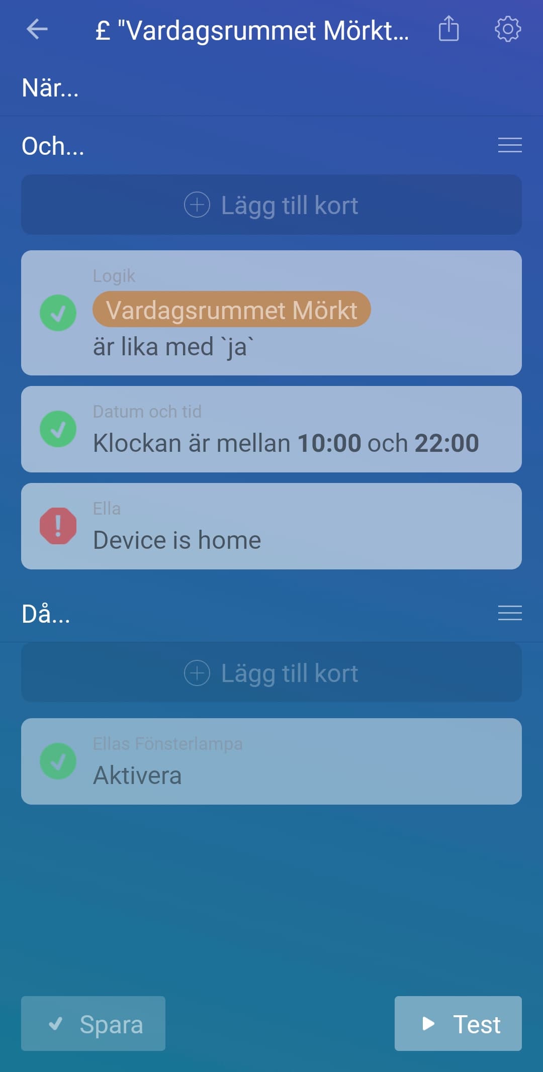

Something is not syncing right since the kast update. Flows are running all the way even if all conditions isn’t met.
