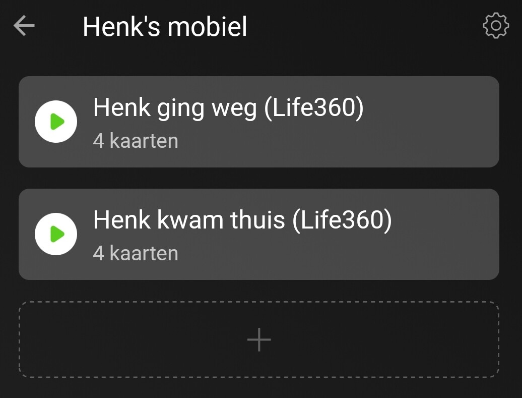

Please, in the homey app go to devices, select your device and check if there are any flows on this device.

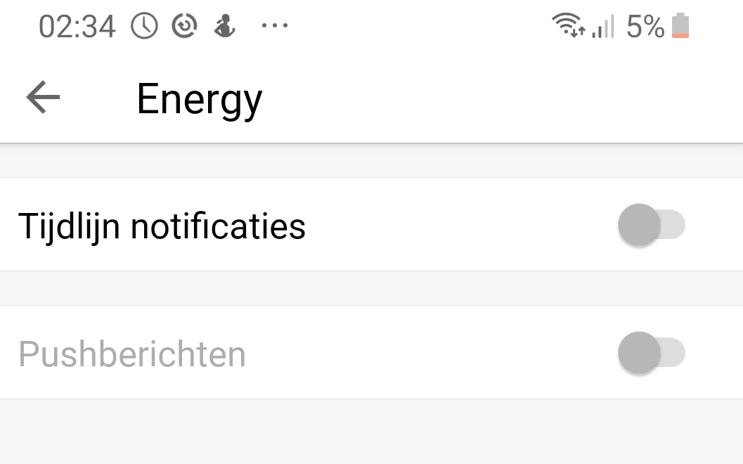

What you also could check is more/settings/notifications is there are any that could send this. Like energy maybe?
No flows for battery notifications:
Don’t see any abnormalities here too.
Notifications for energy are off too:

Disabled the timeline notification for energy and now I don’t see any battery messages.

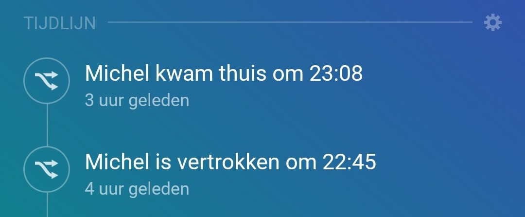

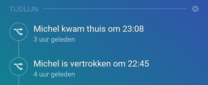

Proof is in the pudding, so check the time of the screenshot when my phone almost died (5% left), and check the timeline notications. Last notification was when I left to walk the dog :blush:.

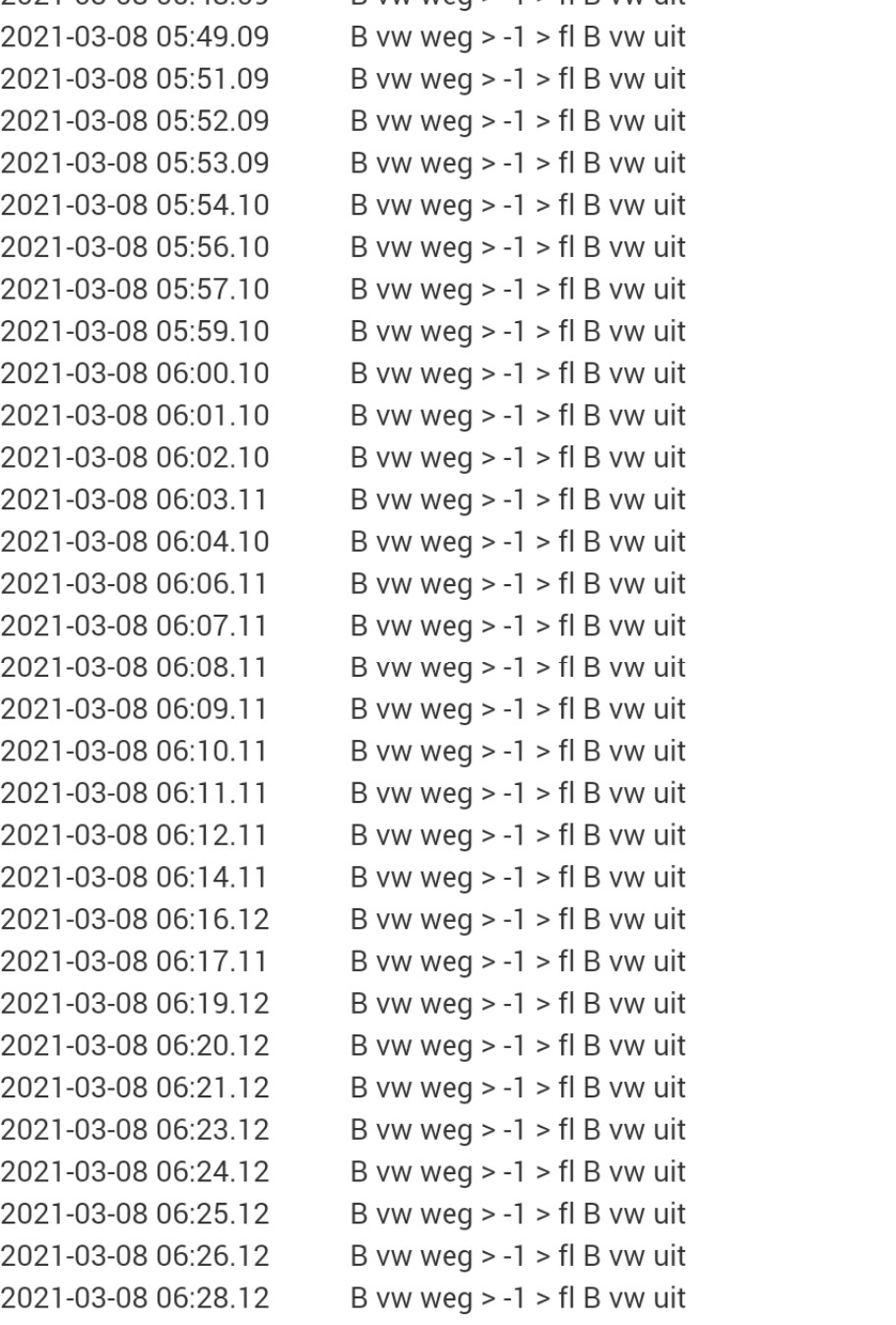

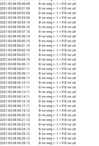

Hi there,
life360 works great en really secure
but now i add a log to it to see when im gone… and then this is what it logs… see picture
on the phone off my girlfriend it works fine and we have the same settings…
Did this ever get resolved @MarcelT ? I am experiencing exactly the same issue when trying to set up the app (v 1.2.4) for the first time (Homey V5).
I am not able to reproduce this :unamused:.
