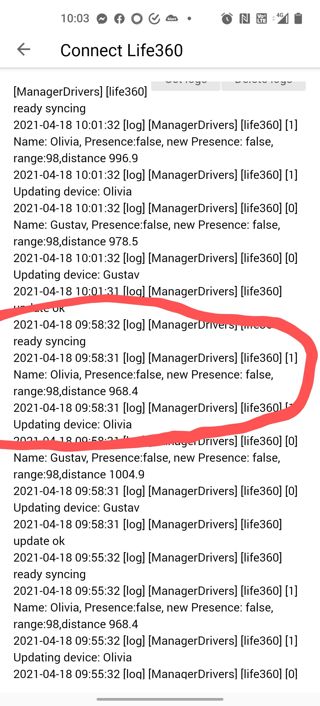

However lately I noticed it started setting my wife as home randomly when we are away.
Added debug logic to make sure what was disarming my house and found her phone.
Both life app and connect360 detailed info are correct.
But looking at the app log it does not set her presence to home (true) BUT it stills triggers the home card in homey.
Any idea idea what the issue could be ?

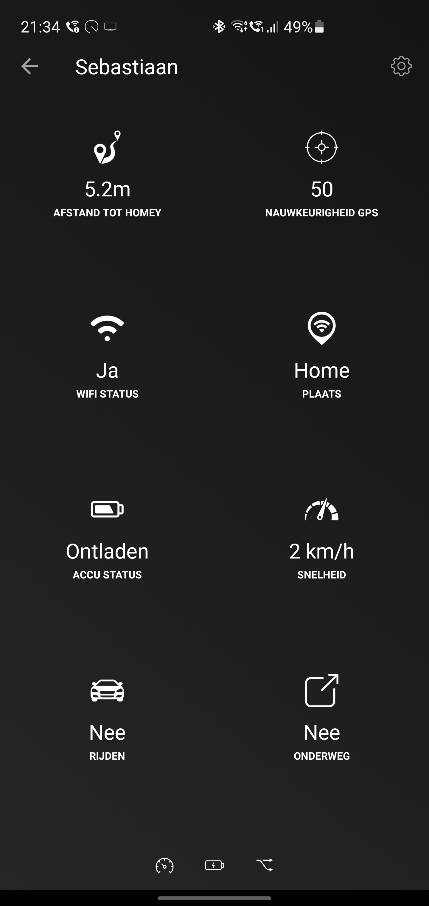

But there is one problem. I have one person at life 360 that is in two circles. In this circles his house is attached on both circles as a favorite place. One is called “home” and the other in the other circle is called “Sebastiaan Home”. In the device you see by “place” it changing from home to Sebastiaan home and back. This way if i use "device is leaving place: “Sebastiaan Home” and it goes to “home” it thinks i’m leaving home. Is it possible that i can choose in setting which circle i want to use?
I am not sure I completely understand it. Is it physical the same location?
I understand this is difficult. I’m a administrator of somebody else it’s homey. Because of his mobile strong battery power saving it share’s the location to the homey app very badly. So i use connect life360. I attached his life 360 account. In this account he has two circles. The family and the friends circle. In the friend circle his house location is called home. At the family it’s called Sebastiaan home. When it’s sharing it’s location to one of the circle it’s changing the location name depending to which location circle it’s sharing it to. Given both circle the same name doesn’t help. You don’t see a name change, but internal it still flips from one to the other. You even see two home in the device leaves place. Meaning he sees it as two same location, same person different circle.
In the two pictures you see how far he is from his homey (5.2m) with two different names. I hope it clarifies a lot more,
