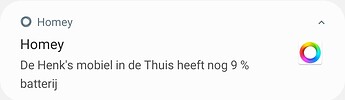

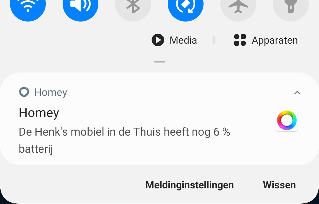

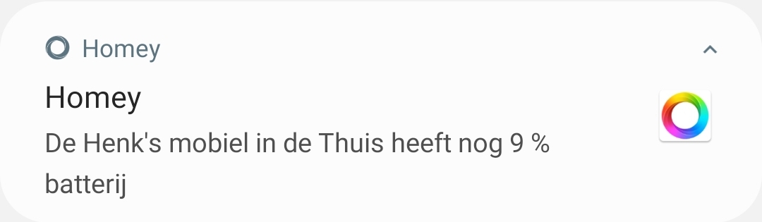

Since a while, I have a strange thing:
Homey sends me notifications that my phone is below a certain battery level (I think below 15%).
And it sends me that message every time the energy level drops 1%. So that are a lo of notifications…
(while discharging and charging, so about 30 notifications)
I did not have this before. As they are notifications to the same phone as that it is reporting the battery level of, I really don’t need those. I can watch the same screen for that information…
I have no flows with battery levels for the Live360 devices in Homey. I cannot change anything in the Homey Life360 app settings, the Life360 app on my (Android) phone, or Homey’s notification settings menu.
Strange thing is that it only reports my phone’s level and not the one of the others in my Life360 circle.
Anyone know how I can disable these notifications?

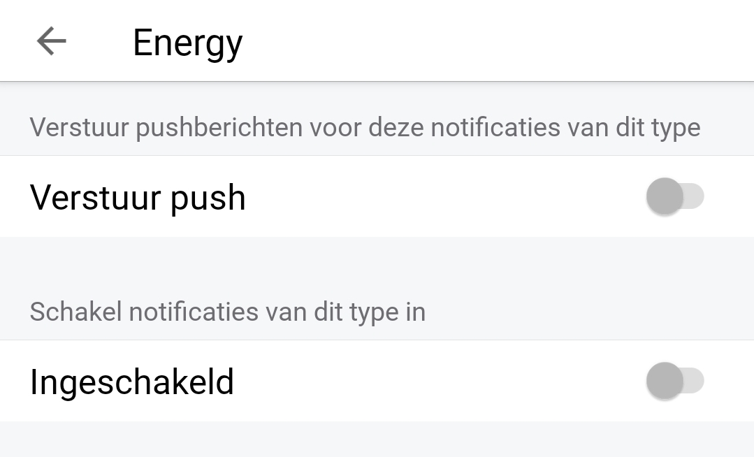

Timeline properties energy?
What do you mean?
It’s about notifications on my phone, not the additions to Homey’s timeline…
But probably misunderstood you?

Hi @MarcelT,
I waited for the notifications after my phones battery came below 15%. Then disabled the (Homey) Life360 app and the notifications stopped.
After enabling the app again, the notifications started to come in again…
Seems it is something triggered from the Homey Life360 app then?
