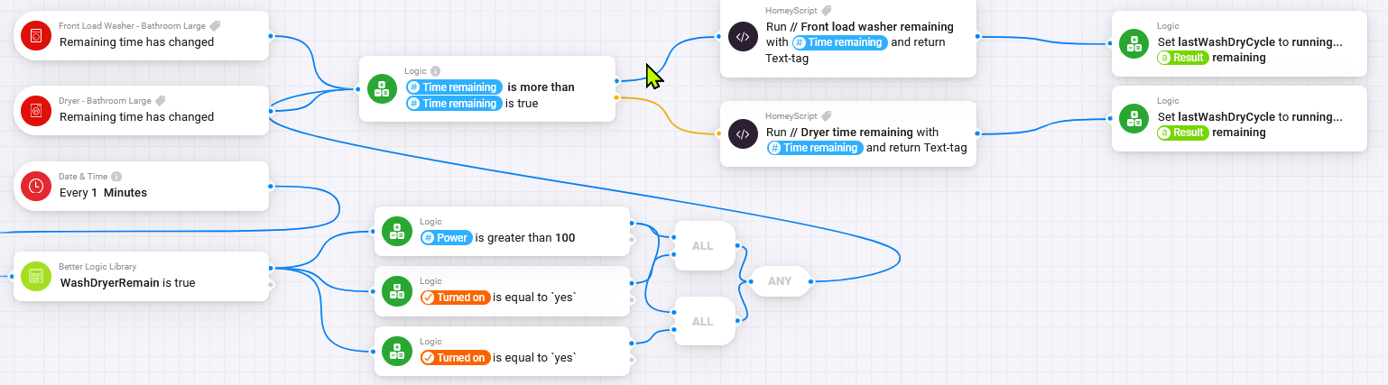

updated to 3.1.11 still nothing new to report, thou the log says *WM-remaintime from # to #
#=a number
but the lable is not updated, i’ve now also added a everyminute card, and my variables updates fine…
done a diagnostics report…

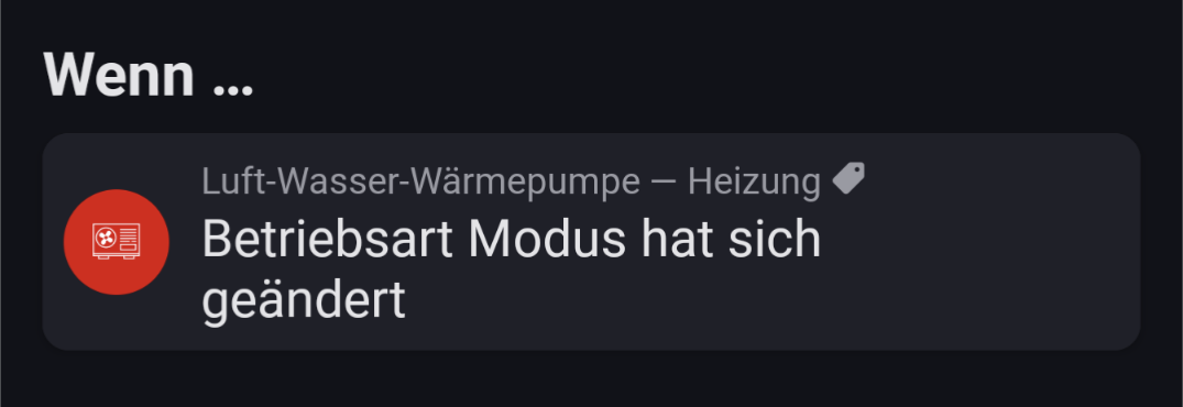

When I change the operational mode ("Betriebsart ") in the LG ThinQ android app, the flow action “Betriebsart Modus has changed” is not being triggered in homey.
Is something that can be fixed?
For now I whish you some nice Christmas days
:santa::santa::santa:
Thank you, Frohe Weihnachten!, looks like i am triggering when opmode is changed, but can you do the change like above and after a minute PM me the log (also are you runnng live or test version (assume test)).
try test version 3.1.12
Works. Thank you :+1::+1::+1::+1:

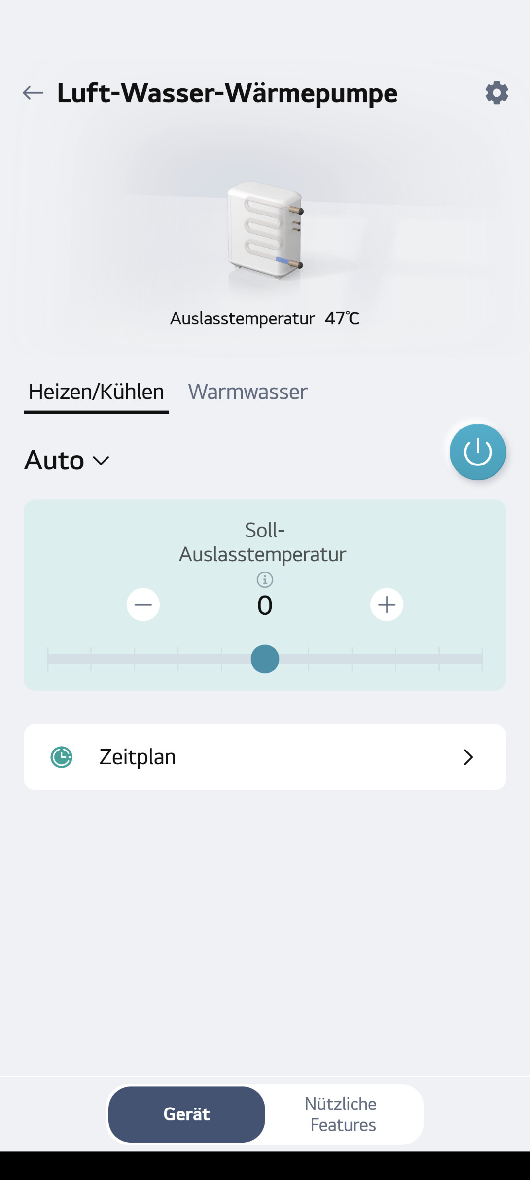

The LG AWHP has three operating modes AI, Heating and Cooling. I am ignoring Cooling as I don’t use that.
The mode Heating is quite clear, the target heating temperature reflects the target temperature for the water out temperature as seen here:
But with the AI mode it is not as clear, because the AI mode doesn’t use a target temperature for heating, but is based on a heating curve, which can be defined in the LG panel. The user only has the option, while AI is set, to adjust the target temperature (from -5 to +5)
The target temperature isn’t indeed visible to the user at all - also not in the LG ThinQ android app. In my view a user has too look at the heating curve and check the outside temperature and then identify the current target temperature on the heating curve. As user I can only directly see the current heating temperature (water out).
While in AI mode a user can adjust in LG the target temperature from -5 to +5 (see above screenshot), but as said before I can’t select a target temperature itself and I don’t see such on the LG panel and not in the LG ThinQ Android app.

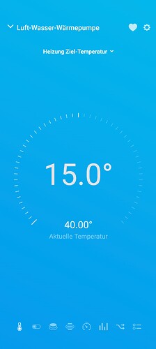

Now comes the confusing part, because in the LG ThinQ homey app, the target heating temperature is set to 17⁰c while switching to AI mode. In the homey app I can change this target temperature from 12 to 22.
Eventhough these are different values compared to the adjustment values (-5 to +5) in the AWHP, these values do correlate. Because, when I change the adjustment values in AWHP, the target heating values are changed in homey and vice versa. They only use different values!
And when I use the regulator in the homey app, you can see that the lowest value I can set is only 15. Besides when I for example select values above 22, like 45, then shortly after, the regulator automatically falls back to the max value 22.
So the values shown in homey cannot be for sure a target heating temperature for the water out (as compared to Heating mode)! Because the water out value can be of course higher than 22!!!
Your logfile shows that after switching to AI, the target temperature ist set from 45 (set while being in mode Heating) to 17.
I don’t really understand what the target heating temperature in the homey LG ThinQ app reflects to while AI mode is active!

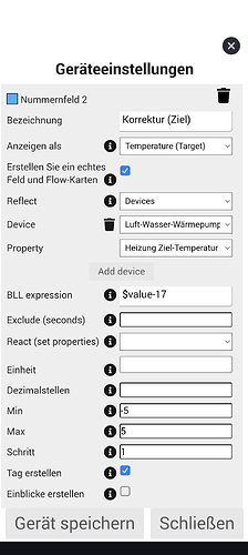

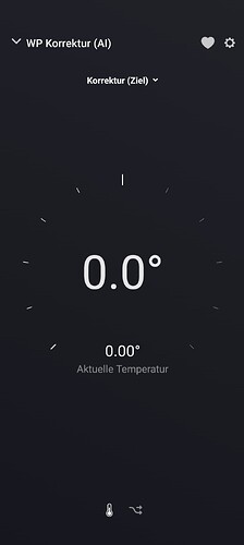

In fact I could even work with the current solution, as I would set the target heating temperature to a value 12 and 22 in a homey flow, which refers to an adjustment between -5 and 5 in the LG AWHP.
For this I created a VD with a regulator with values between -5 and +5. I reference the target heating temp of your app and substract -17. This way I can set the adjustment manually in homey.
But there is another limitation, which you might be able to look into and hopefully solve:

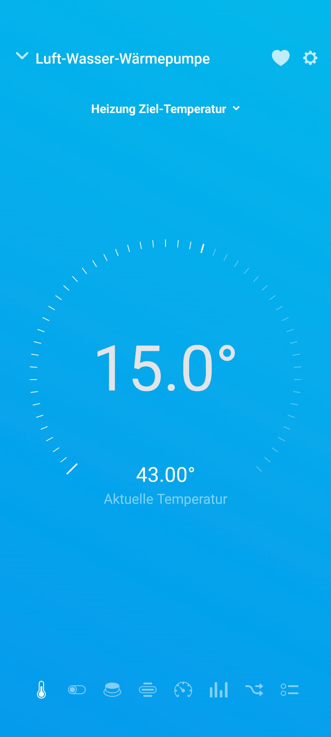

In the homey app I can’t set a target heating temperature below 15. Which means I can adjust the adjustment of the target heating temperature in homey only by maximum -2, whereas the max negative adjustment for the AWHP is -5. When I set the adjustment to -5 directly on the LG panel, the homey app ignores it and shows me a target temp of 15 which corresponds to an adjustment of -2

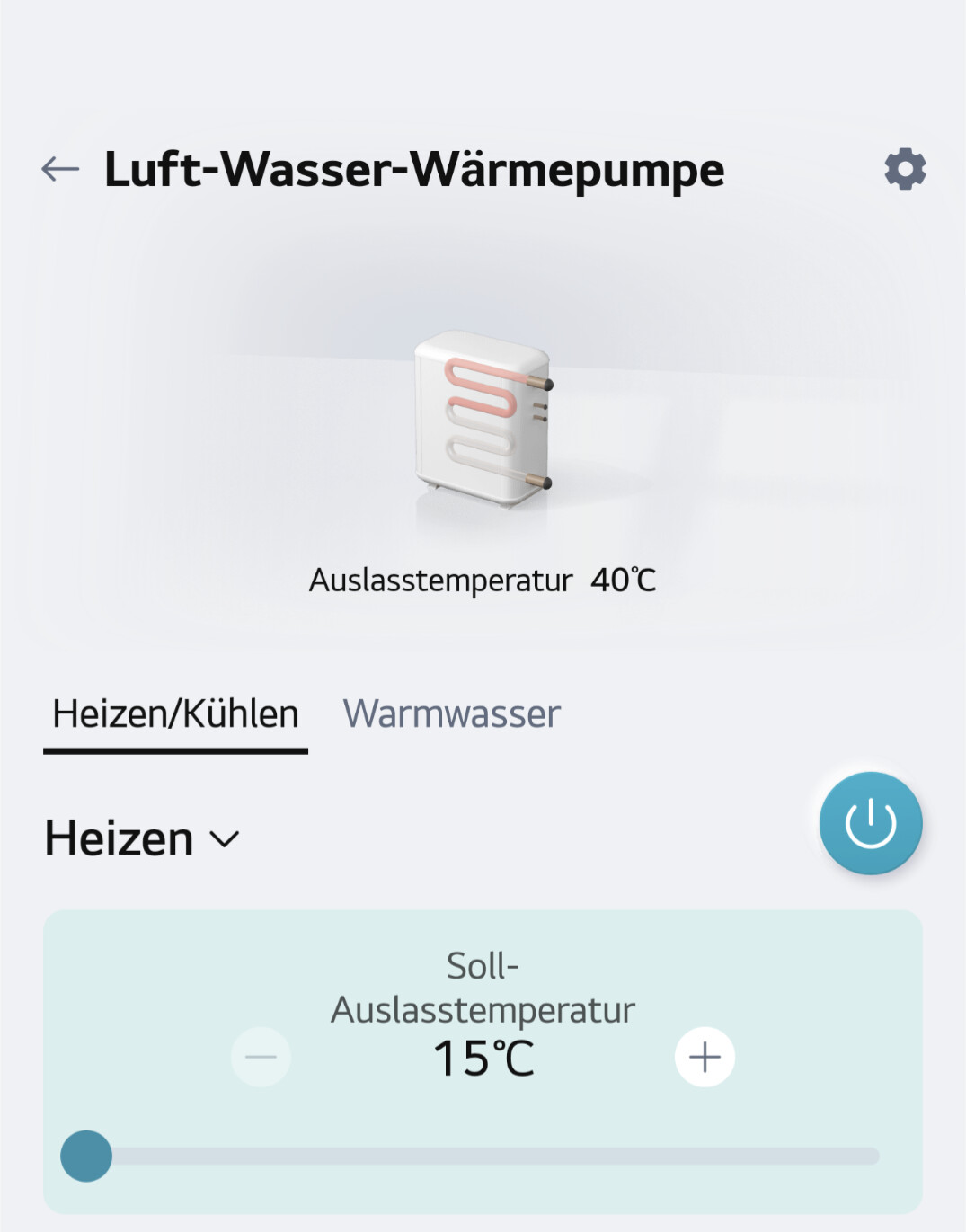

For a short time solution however I would be happy if I would be able to set a temperature of 14, 13 and 12 degrees for the target heating temperature in homey, while AI mode is set. At the moment this is not possible. But I realized that when mode Heizen is set then also the regulator in homey lets me select 15 degrees as lowest value:
This in fact matches exactly the behaviour in the LG ThinkQ App, where 15 degrees is the lowest possible value possible I can set:
So the 15 degrees as minimum value for target heating temperature makes sense while in mode Heizen. However it makes not much sense in the mode AI, as in AI mode I can only set the adjustment from -5 to +5, not a target temperature itself.
So I would need to be able to set 12 degrees in order to set the maximum adjustment of -5. Currently I am limited in setting only -2 as lowest value for the adjustment of the target temperature.
As LG API returns and manages degrees in both modes, I wonder whether it is possible to set a value below 15 degrees in the LG API for both modes, but especially in AI mode. If LG returns an error, than I would say LGs API has a bug as you can’t set the adjustment below -2 thru the API.
Again I hope this makes somehow sense?
