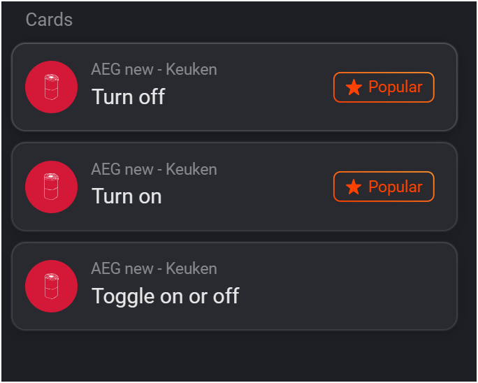

To test this, I installed the new/your app. My impression from the flow cards in the app description in the store are correct, so:
The new/your app shows this with the THEN cards:
With the older app, you could choose the smart or manual mode and set the fan speed. A while ago this stopped working (AEG thing I think?)
image.
This is not working for this/your new app. If it is possible for you to add this, this will be the app to instal for the AirPurifier people.
I hope I gave you the information that can help you to upgrade (or better to say, add) the controls.
** update while writing this answer… I checked the old app to be 100% sure, and that old app had an update a week ago what I didn’t see and guess what. The manual mode and fan speed are working again from the THEN cards **
Reading the above (the fix), I will stick to the older app for now, but maybe in the future with the updated/added controls I will give this new/your app a chance.
