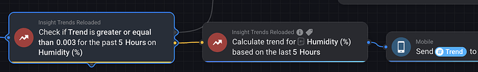

I’m experiencing something similar. The card which is checking “if trend is larger then”, doesn’t work anymore since the update in July. Before it was working just fine, but now it is always false no matter the value. Is this a bug? It worked before and I didn’t change anything. Checked the values, either I’m using it wrong or the card is not able to do proper comparisons anymore.
As you can see, the card is false, but the actual values suggest the oposite.
Also if the values are actually smaller than 0.003 the card is still false, which then would be correct.

Strange Issue, since I didnt changed anything at the code itself. I just updated dependency. I’ll take a look at this issue.

Got your log, thanks! :folded_hands:
The card itself is working correctly:
trend slope: 2.566790501511337e-7
trend (token output): 0.0002566790501511337
trend (token output): 0.0000002566790501511337
args.value: 0.00003
comparison: 0.0002566790501511337 >= 0.00003 → false
comparison: 0.0000002566790501511337 >= 0.00003 → false
data points: 119
min/max: 59.7 / 68.3
The issue isn’t with the comparison. So mathematically, everything matches up

But it isn’t mathematically correct, it should be true:
Oh, maybe i missed something.
2.566790501511337×10−7 should be 0.0000002566790501511337 and not 0.0002566790501511337
Edit:
I do on the “caluclate trend” a modification on the trend (* 1000)
trend: app.significantFigures ? FlowUtils.toSignificantDigits(Trend.createTrend(logs).slope * 1000, app.significantFiguresValue) : Trend.createTrend(logs).slope * 1000,
So, should I rework the Trend Slope to make it more readable or keep it as low as it its? This is a question to everyone that uses the trend
Edit 2:
New test version is online where I removed the * 1000 modification.

Yeah, I actually removed the *1000 factor, but as you can see in @L3nny’s post, the resulting trend values get super tiny (like 0.000000...).
and maybe even in general “per hour”?" I guess it’s very unrealistic in home automatiion context to even monitor “changes per second”.
I think important is that values are identical throughout the app (claculated values vs. shown value on configuration page)
actually e.g. my threshold is something like 0.3 °C / hour
For trend I don’t need seconds, but I need it in minutes. I need a detection, that someone used the shower. Which I use the trend for. If humidity trend is higher as …
This way I can use the very steep change of the humidity in the bathroom to identify that someone showered. Just using a percentage value would also work, but would create false positives on very humid sommer days.
The newest test version works for me now. Need to figure out the correct trend number, but that is no issue. Also the settings card delivers the same number as the flow card.
