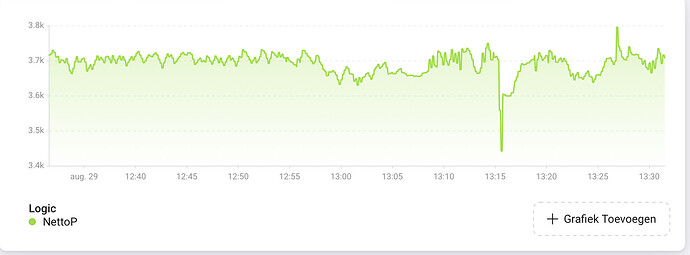

Hello;
Thanks for your work.
This simple flow is not working.
What is going wrong please?
Thx for your help!
Looks like the data is somehow 0.
How does it look in homey insights?
This is the result.
NettoP works fine. Insight NettoP doesn’t work.
