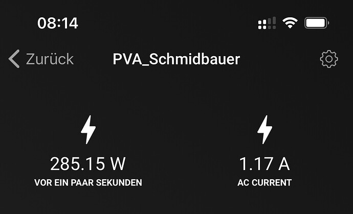

So, I changed my PC Power Meter to update every 10 secounds. Insights are showing them fine so does my app.
2023-05-28T08:04:00.803Z [log] [InsightTrendsReloaded] Got 720 entries from homey with timespan(5min) of lastHour for homey:device:1bfecf85-030c-4e9e-a636-e91fef9f7c95 - homey:device:1bfecf85-030c-4e9e-a636-e91fef9f7c95:meter_po
wer
2023-05-28T08:04:00.803Z [log] [InsightTrendsReloaded] After FilterNullValues(true) the length is 720
2023-05-28T08:04:00.803Z [log] [InsightTrendsReloaded] After Date Filter(1685260740803) the length is 59
I got 59 Values for the last 5min
