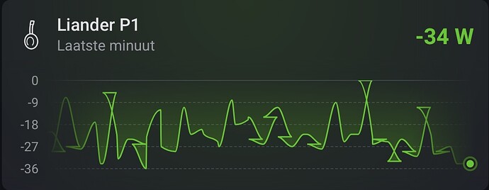

To be clear, it was a question why polling was every 10 seconds. As it turns out, the Homey doesn’t handle 1 second very well. It’s fine that the update has been rolled back. But my Homey still gets an update every second. Not bad, but it still gives a problem sometimes.
In the energy graph I sometimes get crossing lines. Probably because Homey is being overloaded. So I think we can conclude that polling every 10 seconds is the best. (it remains a consumer system) That leaves one question open. How do I get my early 2019 Homey (12.4. 0) back to 10 second polling?

  • Adjusted P1 polling for Homey Early 2019 older/slower models (10s), HomeyPro2023 will stay 1s
At an early 2019, 10 seconds polling now works well again. Thank you!
