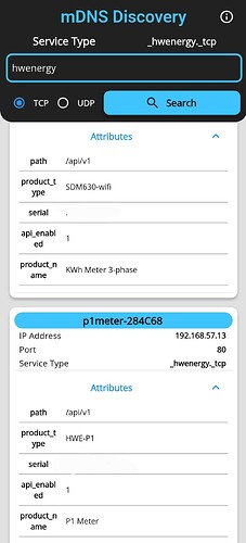

Further share me screen shot of both mdns discovery results from your phone.
You can blur your serial number like me:
When you try to add the P1 and your SDM630 do not press any button on those devices. My app doesnt ask for it so keep them untouched.

See screenshot attached

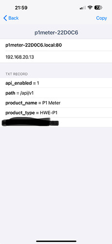

I have since a couple of days the same issue, can the Homey update to V12.5.3 be the cause?
HomeWizard Wifi signaal is 110 RSI
