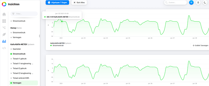

When searching for new ā€˜kwh meter (1 phase)’ devices, it also found this one:
2021-06-07_162314
The data are almost the same as the P1 Dongle is giving. But it is not showing everything. Normaly I have day and night metering.
Homewizard app 2.0.5 beta
The chart from Insight are not right for the Current. Current should be in Amps, not in Watts. It looks like both Power and Current are the same charts :wink:
Strange I don’t touch those. Default from Homey insight so do me a favor and sent me a PM with your api output for this device to verify.
P1 dongle is doing the same, both current and power in Watts. Other devices like NEO Coolcam do it right.
I will sent you my API output, but think the problem is somewhere else.
P1 dongle api shows Watts in the api so not sure why you say it is wrong.
When you talk about ā€˜Stroomverbruik’ (Current in ENG), it must be in Amps. Watts is Power.
Now the chart says it would show a current chart but is actually showing a power chart with the name ā€˜Stroomverbruik’
ā€œStroomverbruikā€ is the default text from Homey so I must overwrite it with other text now to make it match your expectation.
Or remove it. Because ā€˜Huidig vermogen’ is the same chart.

You are Incorrect.
amperage = stroom (so no ā€œverbruikā€/ā€œusageā€ as suffix).
It still isn’t correct as ā€œstroomverbruikā€ (capability: meter_power) should be in kWh though, seems more like an Homey or WebUI error then an app error.
And the value being incorrectly chosen/displayed in the GUI
Try rebooting your Homey and see if that fixes it.
Reboot didn’t solve the problem.
But am I the only one with charts named ā€˜stroomverbruik’ and showing power (W)? Don’t think so… :grimacing:
I have stroomverbruik (which seems to be a default additional option in insight). Funny enough mine does NOT show the Huidig Vermogen but states ā€œVermogenā€ which also is in watts. So yes its watts for me.
AndrĆ©-Marie AmpĆØre (1775-1836) would not be happy with that… :wink:
Not my problem, am just another developer utilizing Athom/Homey sdk code.
Don’t shoot the messenger and it is all volunteering work.
Seems like the insight gui is acting on its own as I have flagged Huidig Vermogen and not vermogen or Stroomverbruik as per insight.
So this needs to go to support @ athom not matching the code what the driver covers.
I’m not blaming you at all. Let’s see if Homey can do something about it.

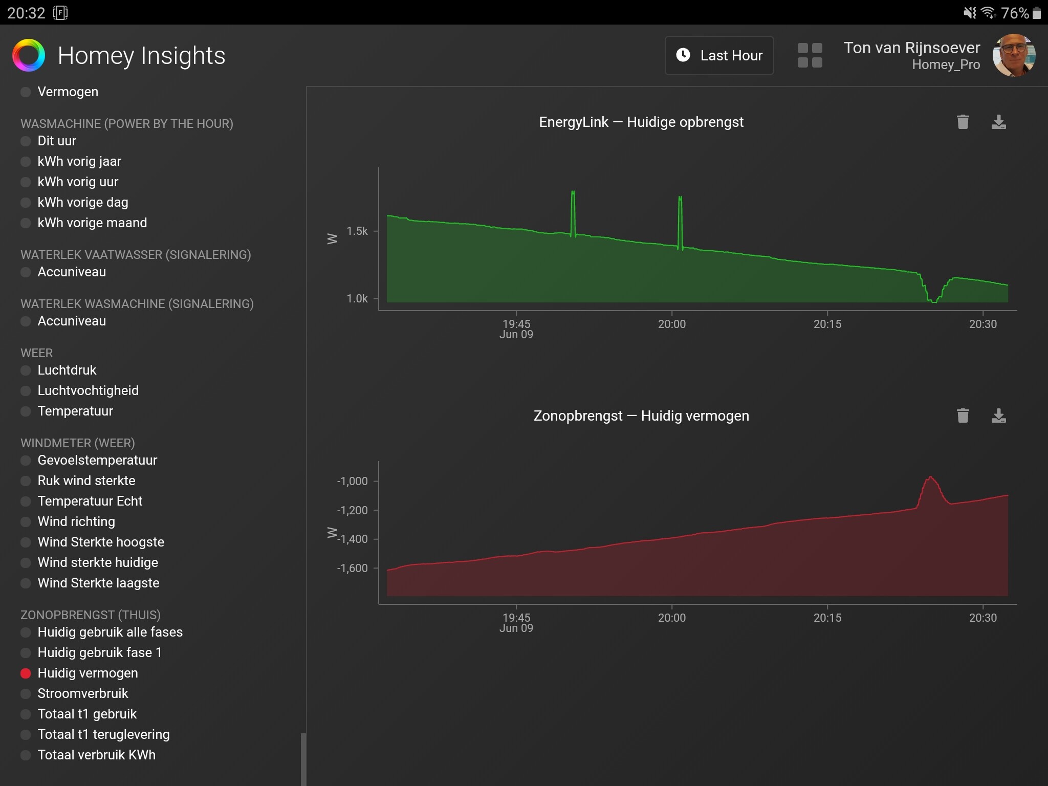

hey , @Jeroen_Tebbens
is it true that the value of the kWh meter indicates negative values. while via energy link the values ​​are positive.
