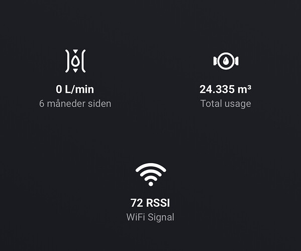

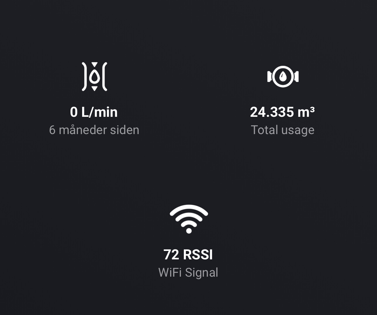

The water meter at my cabin have not registered L/m as of january but still counts m3
Also in homewizzard app it works .
Do you think i need to re-add it next time i am at the cabin or is there a setting i have to set ?
Cabin? Maybe lost power? Accesspoint problem there?
Interval changed?
Well it still register m3 when someone use water ,it is only the l/m that is missing . So it is connected to power and wifi (and also works fine in homewizard app.
I will try to re add next time and i am there . Just seems so strange .

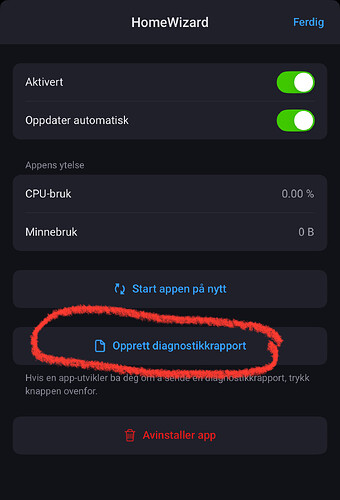

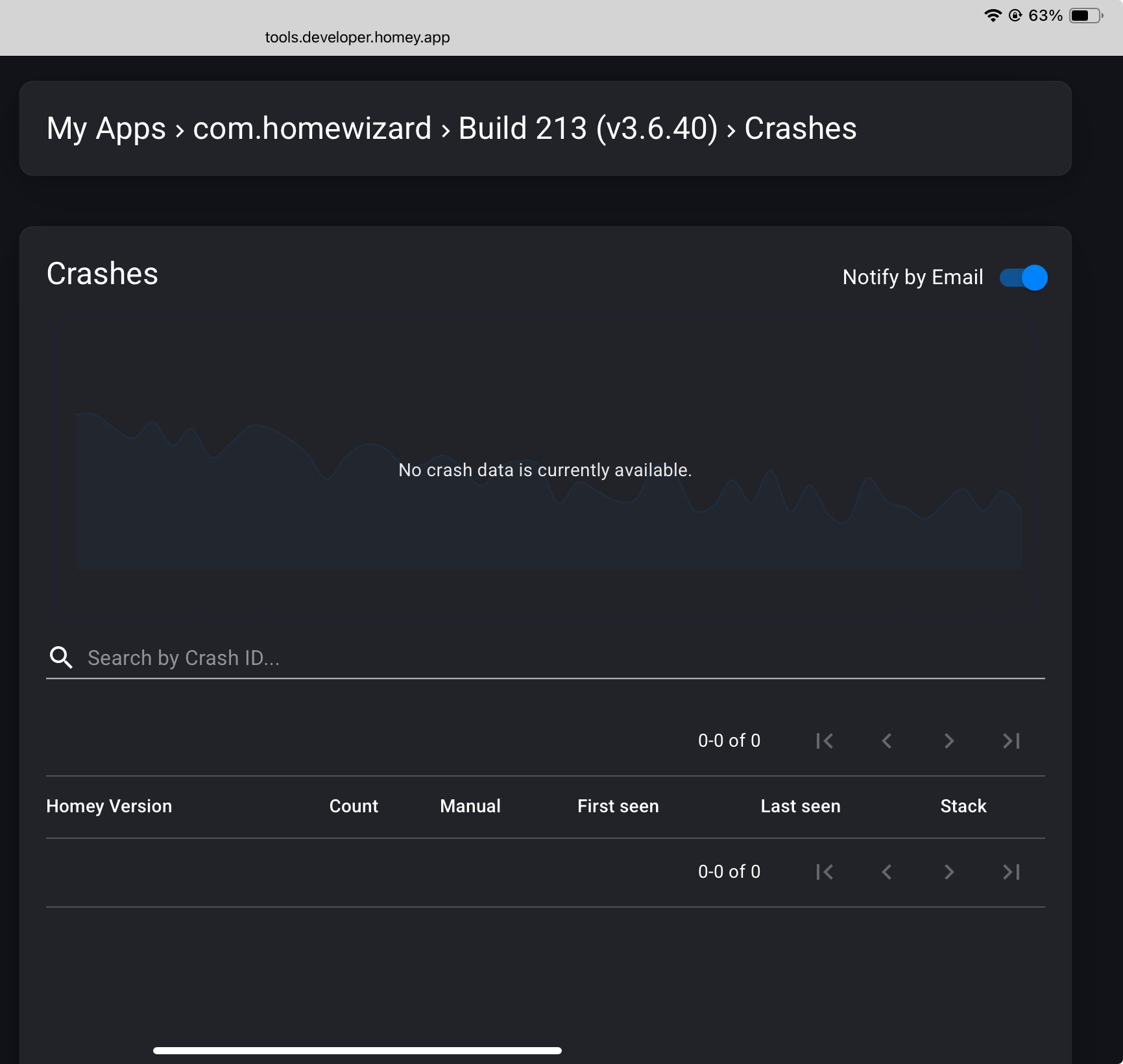

I received nothing, you are sure ypu ticked my diag report and not Homey itself? Else your Homey has a bigger problem.
dcdc759d-028d-4ab4-8f9e-7ceb29cf79f6
Nothing…so your Homey has a problem fix that first. Reboot? Firmware update? Dunno but I cant help it.
249196a3-ffd7-4d0c-8ebf-a5959f0efd4b
Everything else seems to work fine do not know why it will not send diag. to you.
Restartet homey and sent you a report again.
Yes got a report now so restart Homey helped. Nothing on watermeter atm. Lets see if that reboot helped.

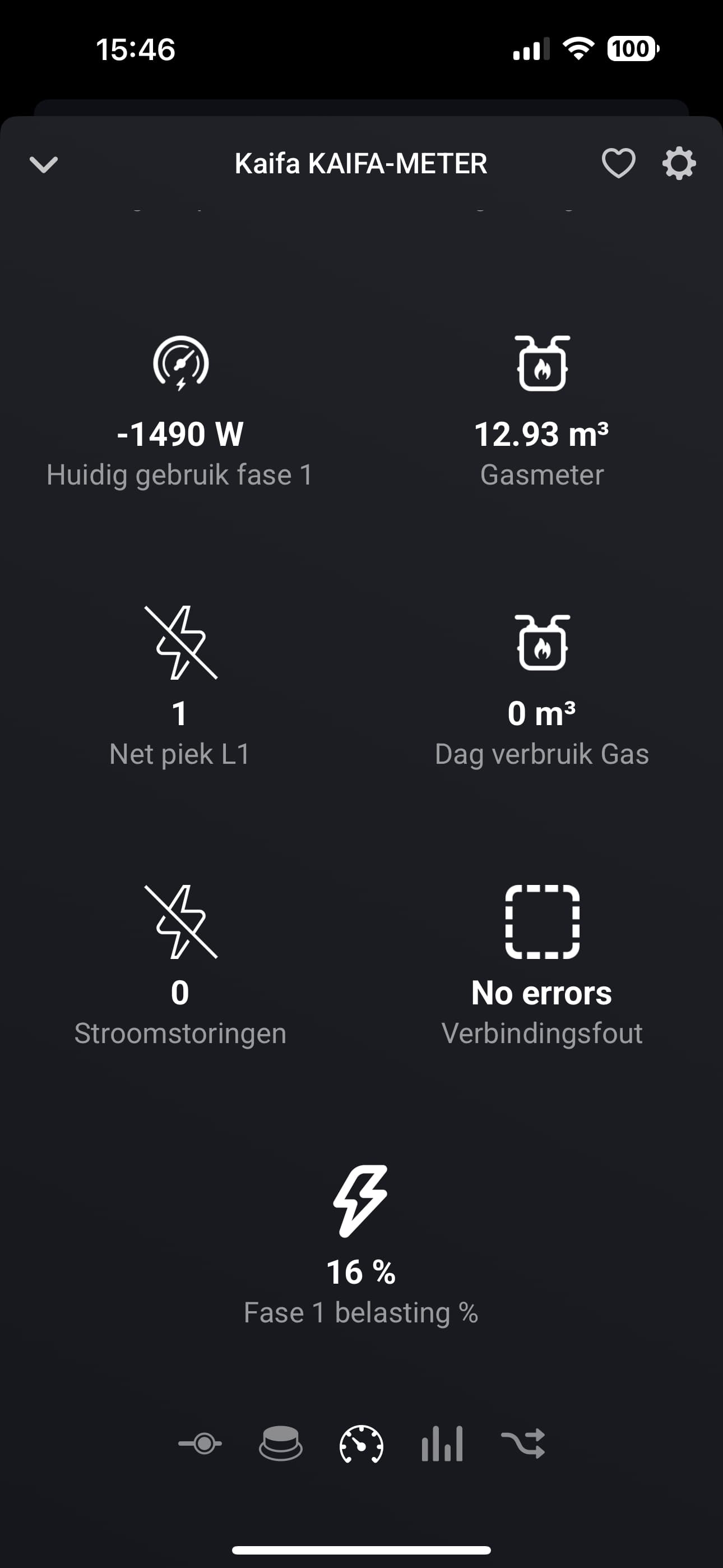

New in test v3.6.41
  • Added phase monitoring
  • Adjust settings to align with your energy grid
Adjust settings with your P1
Indication bar on how fully loaded the phase is (could not test 3 phase as I have 1 phase here)
Percent capability to trace, there will also be a notification in your timeline when the capacity is 95% of the limit.

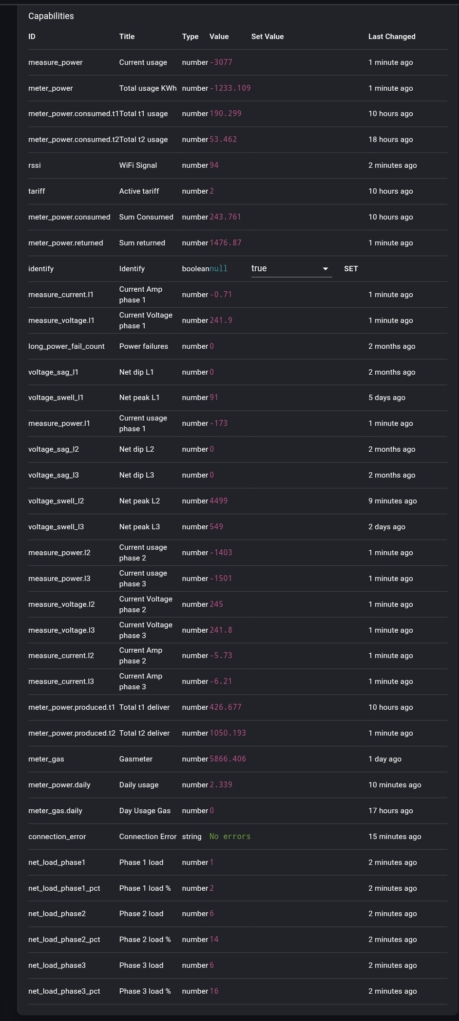

Super. For me v3.6.41 doesn’t work quite yet, I do happen to have a 3 phase meter :wink: so I’m happy to test things for you.
(Homey Pro 2019)
e78b6e63-e8dc-4ebc-8eb9-e92d2f5db1f9
Things still seems to work ‘underwater’:
Yeah as said, no phase 3 grid here…

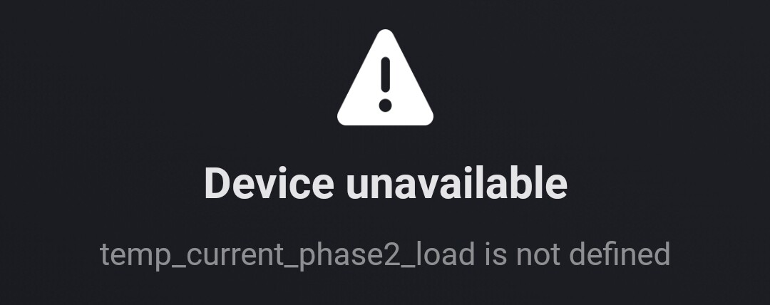

Fixed v3.6.42
Bugfix - ReferenceError: temp_current_phase2_load is not defined
