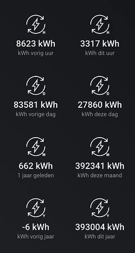

Jeroen, is it possible to also show the daily consumption with the P1 meter?
Something like this
Use Power by the Hour app for that. Pointless for me to add such code while there is a great app that does that.
I use “Power by the Hour” but I get such extreme deviation values ​​that it cannot be used.
I removed the “Power by the Hour” meter and added it again. Let’s wait and see what the result is
Somehow the link between P1 and the “Power by the Hour” doesn’t work. After adding it the _power stable remains

Back to why I would like to see the daily consumption in the P1 meter.
You referred me to “Power by the Hour” However, that only updates the data once per hour plus it subtracts the generated power from the consumed power.
I have been logging to Pvoutput via Domoticz since 2013. I now want to do this with Homey. That is why it would be nice if you could see the total daily consumption in the P1 meter so that it can be exported.
