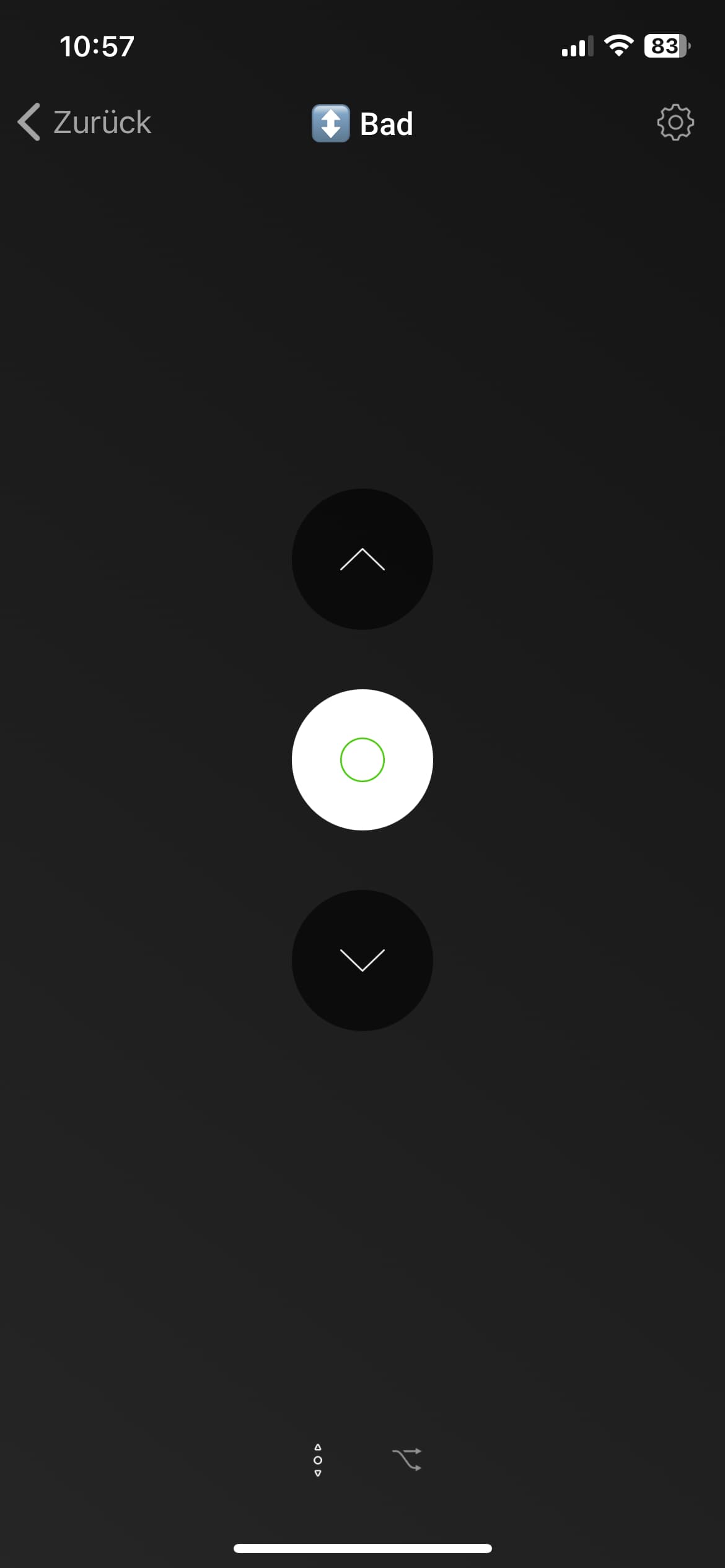

Another topic (I switched from HomeyKit to HomeKitty):
I noticed a strange behavior with my Somfy RTS blinds, which are integrated via the official Somfy app:
Under HomeyKit, the operation worked as expected:
(Homey-App) ∧ = Up, ā—Ž = My-Position, ∨ = Down
(Home-App) Top = Up, Middle = My-Position, Bottom = Down .
After I switched to HomeKitty, the blinds reappeared in HomeKit but their operation had changed, both in the Homey app and in the Home-App:
∧ = Up, ā—Ž = very short movement of the blind, ∨ = Down (Homey app)
Top = Up, Middle = very short movement of the blind, Bottom = Down (Home app).
And: Some blinds moved randomly (open, My or close) only by opening the Home App or without any interaction.
I solved the problem for now by removing the blinds from HomeKitty again and reactivating HomeyKit for this purpose.
Maybe you’ll find an opportunity to address this issue?
