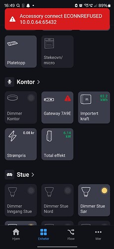

I have a problem with the homekit controller app. I am using the Homekit controller to controll a SG gateway. It works fine for some houers, then i loose the connection and need to restart the app the get it to work again.
Due you know what could be the problem?
Brgs

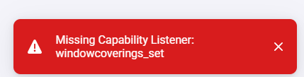

Since X-mas I’m getting errors with the Roller Shade devices connected through my RA-Pulse Bridge. Before X-mas everything was functional, except for the “open” command issue posted previously (sorry for not getting back to you on that one).
Since X-mas when trying to control the Roller Shade devices I get a “Missing Capability Listener” pop up error and a different variable listed in on the pop up depending on the action I was attempting, e.g. “windowcoverings_closed” if I use the open/close button, or “windowcoverings_set” if I try to specify an open % with the slider.
Given it had worked previously, I’m assuming the cause is a software change or update somewhere between the bridge or the homekit controller app.

Hi @Martin_Verbeek,
Not sure if you did something overnight (my time), but the issue appears to have been resolved.
If it was an action / update you made, Thank You, but if not, it would be interesting to understand what did change both to cause the issue and then to resolve it.
Cheers,
Mark
It has AI, so it repaired itself :flushed::flushed::flushed:
No, just kidding, I had checked if I changed anything in that area, but nothing that I could discover

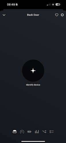

Hi I’m having trouble. I got all my eufy locks into homey, via this option but it made everything where I’m just able to identify it, not use it. It shows that’s it’s a lock but won’t let me function it like one
