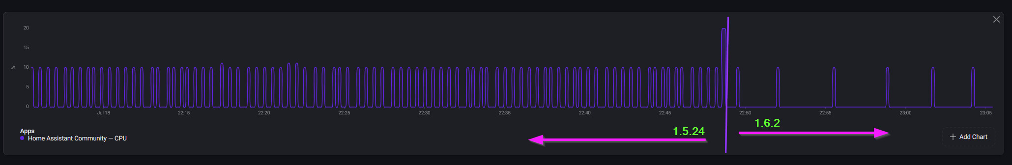

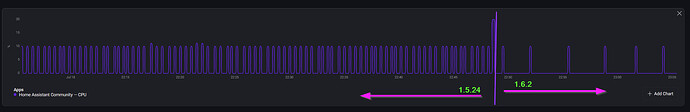

I would be interested in some insights screenshots from power users comparing old/new versions CPU usage :smiling_face:
6hour
:+1: :+1: :+1:
Well done !
I am “just” a light user:
A 7 days chart would be nice, too.
The hourly/daily charts are a bit ugly. It seems, Homey only counts up the usage to a level and puts a 10% mark. The insights from 7day chart or longer period are more realistic.
Thx. So it seems to be general to get it from 4% to below 1%.
